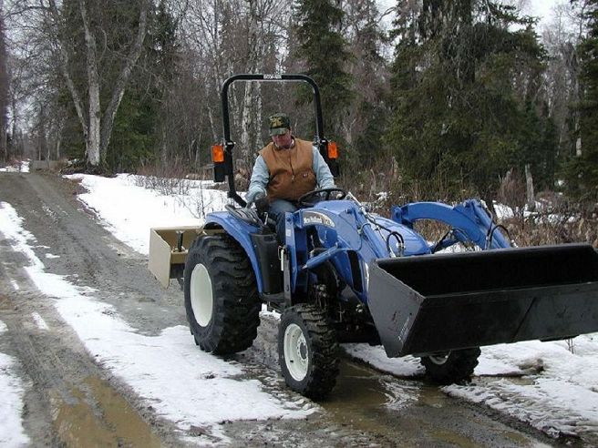

Hi Tim my wife and I just purchased a tc33da. I did not want to buy too small or too big of a tractor. we have 18 acr of wooded land. I have 35 hrs on my tractor, and in that time have done much clearing of land, stump removel, gradeing with the box scrapper. my loader works great. just yesterday I dug in a water line for the house we are building. 10 ft deep and 95 ft of trench. (rented backhoe) and when it came time to back fill all that sand my tc33da made short work of it. I love my 33 and i know i bought rite. we have a small lawn at this point and so we mow buy hand. I am sure at some point ill have to get mower for our 33. The 33 set up with the r4 tires 4 wheel drive and hst makes one very nice tractor. good luck and I know you would be very happy with the tc33da.
