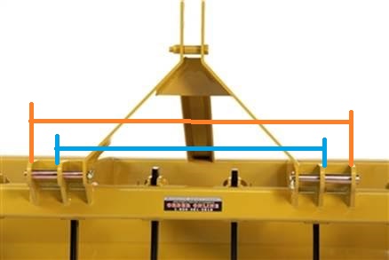

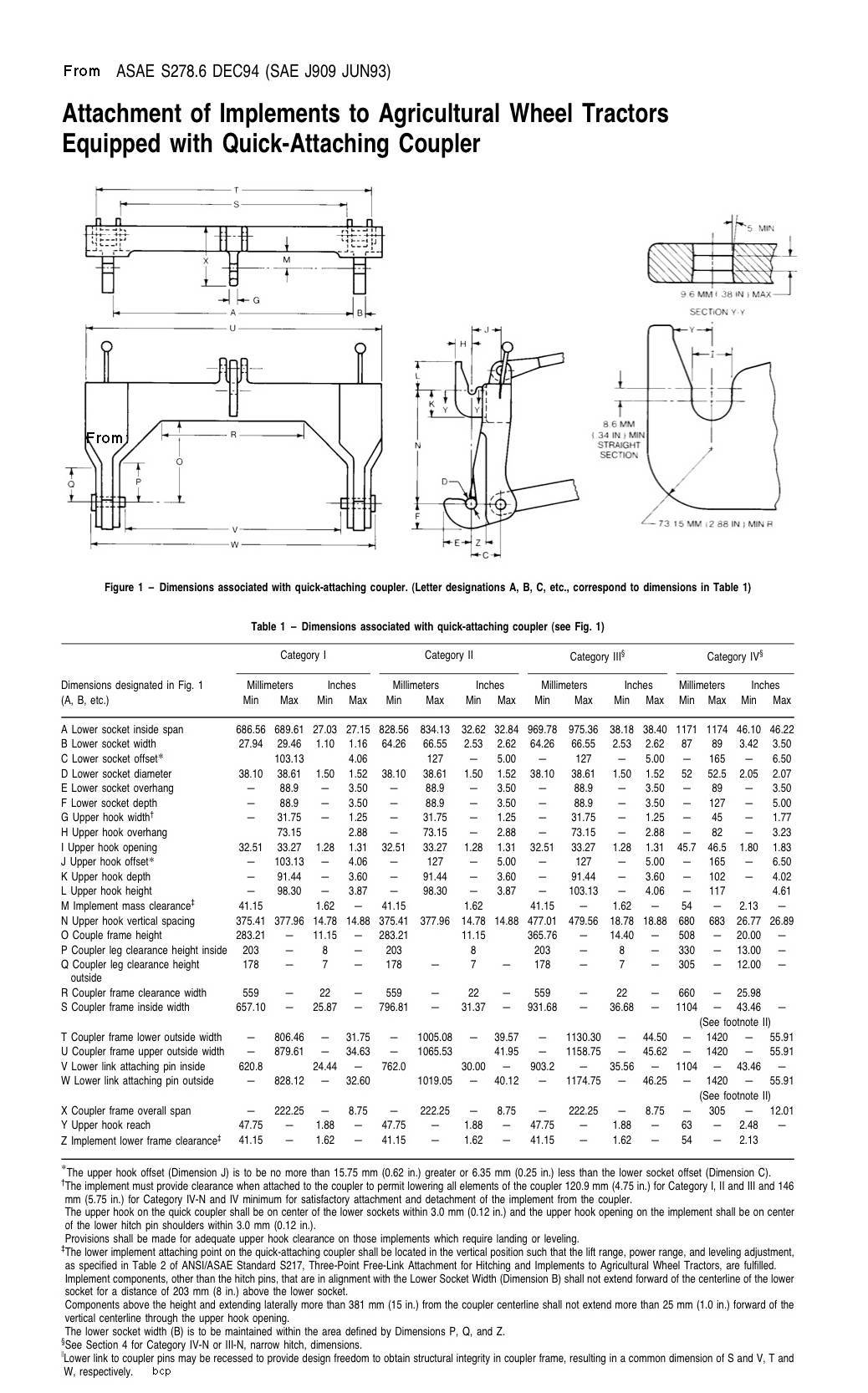

Does anyone have an Everything Attachments Category I & II Severe XTreme Duty Box Blade V1.0 or version 2.0? I contacted their support, which indicated the measurements for Cat 2 in the picture are 31 ¾ - 34 ¾ These measurements seen odd to me as it would indicate the Cat 2 slots are only 1½ wide on each side. I am wanting to use this box blade with a John Deere Cat 2 Quick Hitch (part#TY16042) since John Deere(Frontier) doesn't sell any box blade with Cat 2 till you reach $3,800
The John Deere Cat 2 quick hitch (part#TY16042) I believe is 32 ¾ - 36 ¼
So it appears these box blades are not compatible with the John Deere Cat 2 Quick hitch? or did they just send the wrong measurements?

This may help regarding the measurements:

Someone gave you some bad info.
It's 31 1/2" and 37 1/2" give or take 1/8" according to my tape measure, which should be well within the Cat II QH spec.

Thanks everyone. I did follow-up with them and it was just a simple mis-measure. It is in fact 31 7/8” – 37 ¾ which is well with in the Cat 2 quick hitch spec.
If anyone else finds this thread. Yes this boxblade is compatible with John Deere Cat 2 quick hitch. The guys at Everything Attachments have been great as well. Thanks again and will be placing my order soon.
