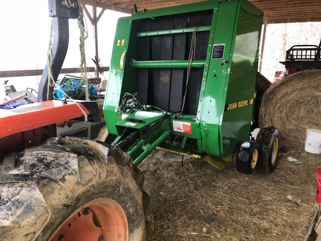

What tractor are you running the JD 335 with?
I just picked one up last month.
