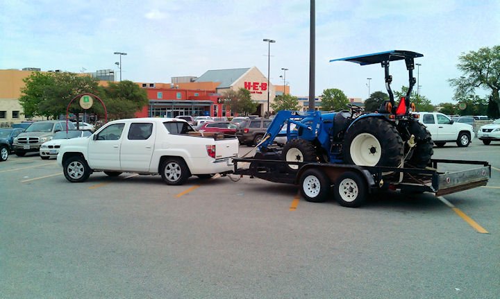

I towed my new R4041H home today on a 16ft dual axle trailer with electric brakes using my Honda Ridgeline pickup (v6 - 255 hp). I limited my speed to no more than 60 MPH for safety reasons, but it had no trouble pulling the trailer for over 100 miles through the central Texas hill country from Austin to Gatesville.

Nice. Isn't the tow Max on that around 5000lbs?

It is...and a 4041 with loader, and bucket is over 5k without the trailer :eek:

The maximum towing limit for the Ridgeline is 5000 lbs, but since I had brakes on the trailer it had no trouble stopping the load. I figured that I was prettly close to 5000 lbs with the loader and tractor combined. It would have been easier with a 3/4 ton pickup, but I got the job done anyway.

A 4041 with loader, and bucket is over 5,000, plus you have a canopy....probably 5,300 minimum, then another 1,500+ for the trailer. So, you were only about a ton over the listed max....brakes, or not. :eek:
You did it, but that doesn't really make it safe. Judging from the squat on the rear of the Ridgeline, it's pretty obviously overloaded.
