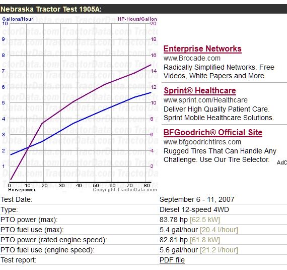

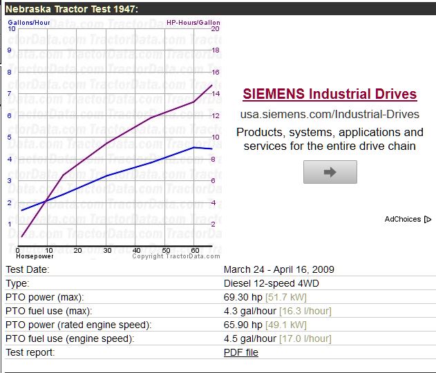

Could someone enlighten me about the E series engines. The 5083E, 5093E and the 5101E engines all have the same displacement. I'm assuming the differences are in the injection and ignition systems with the larger horsepower engine presumably being subject to higher compression and thus more stress. How does this play out as far as service and durability? Will the 5101 last as long and be as trouble-free as, say, the 5083? I also wonder what the differences are in fuel consumption. Thank you.
   / Question about JD 5101E engine #2
I think the differences in HP output is controlled by inj pump and injectors. Both tractors are rated at 2400 rpm's and are tier ll.
