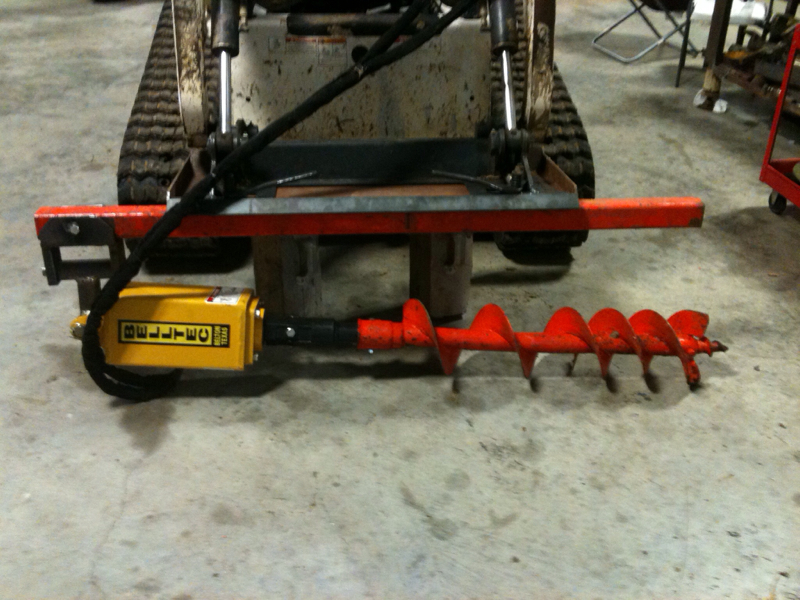

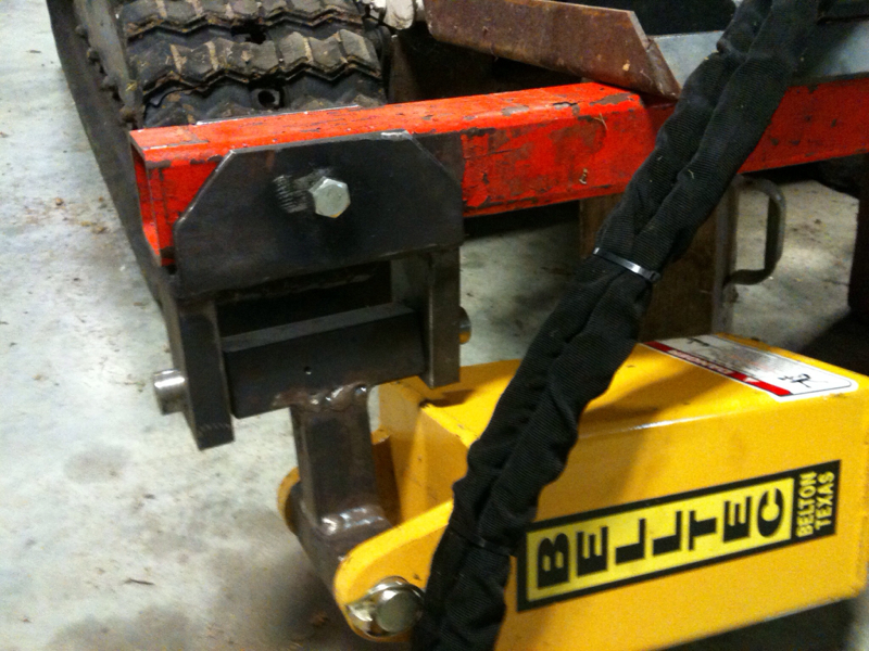

Auger mount allows auger to fold close to mount, easily fits on trailer. Chain hold auger folded to mount is not shown

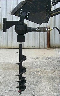

You might consider that perhaps 95-99% of post hole diggers use gravity to keep the auger point down. If you make a slight adjustment in augerCG possible you should have a plumb auger bit. This will greatly reduce cost. My photo shows two swivel pins 90 degrees apart. K.I.S.S.
The arc movement of the bucket travel is such that for a straight plumb hole you need to back up and go forward as you drill. Most of us ignore this without issue. Some bobcats have a vertical travel lift arm geometry.

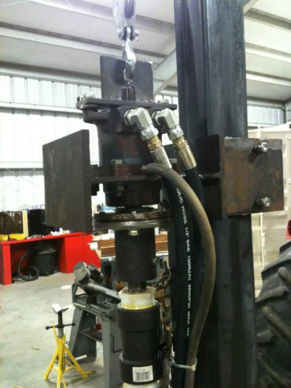

I build this one from scratch about 6 years ago, the 12" auger part is the only thing i bought.
I dug at least a hundred 4-5' deep holes with it without an isue
I can mount it on any of the 3 front end loaders i have.

Looks good! Any idea the specs on the motor you used?
I was just browsing through ebay. There are a LOT of hydro motors on there. Not many of them are specified as wheel motors though. Visually they look mostly the same except for the output shaft. But beyond that I have no clue if they would be even close. It may be worth the extra money to just buy a new one and know what I'm getting. Not sure... Any thoughts anyone?
I have no clue as the identification plate is to damaged to read. I got this motor at a scrap yard for free.
It is a roller motor and has a 1/14" keyed shaft and it makes max 85 rpm being fed by a 25 gal/min pump at 2250 psi.
It works fine with the 12" auger bit as long as i take it easy as the bit will stop turning when i put to much down pressure on it.
It could be that the motor is somewhat worn which might be the reason it was in the scrap yard to start with but so far so good.
I drilled another 30+ holes this summer without an issue.

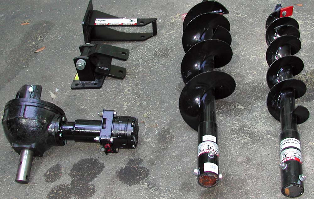

Cubic Inch Displacement
That's a big motor and you will need something that big to go direct-drive. Then you will have
the axial load problem mentioned above.
The approach I used is to go with a much smaller conventional motor of about 7 ci, and a 3.18:1
gear reduction box. Mounted at right angle, this also gives me more clearance in terms of loader
or backhoe or 3-pt height. And no axial loads to the motor. And no fancy taper-shaft adapter.
I modeled my DIY unit after the Worksaver 714H unit, the least expensive hyd PHD I am aware of.
The gearbox is from Agrisupply, and the motor I used is a White 500-series.
I bought and mounted 2 of the 714Hs to my backhoes, before I made this one. The Worksaver
unit costs about $1700, and the 48" HD augers start at about $250-300 each. My DIY unit
is not going to be used, so it is for sale locally for $1200 including 2 Worksaver augers.
