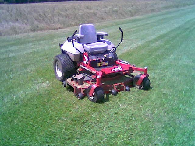

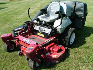

Does anyone know what this type of setup is that's on top of the front wheels?
VS this which I normally see?
   / Question about Exmark setup
#2
Ah, your probably right cause I only seen that setup when it had the grass catcher on the back. I suppose that makes sense.
Thanks

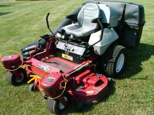

Looks like cast weights as has been mentioned. It appears that they also have a set of weight plates under the middle of the mower. See the area outlined in orange in the picture below.
When I worked for a lawn care company, we had liquid cooled 60" and 72" exmarks. The 60" machines had weight plates in the front middle because the deck was not heavy enough to counterbalance the weight of the engine in the back.

I've seen the plates under the middle of the mower before but I've just never seen weights directly over the top of the wheels.
   / Question about Exmark setup #5
Weight kits are standard when you get a grass catcher. I am very unhappy with the poor design of the catcher I have on my HUSTLER mower and the inadequate amount of weight provided. I do however like the mower.
