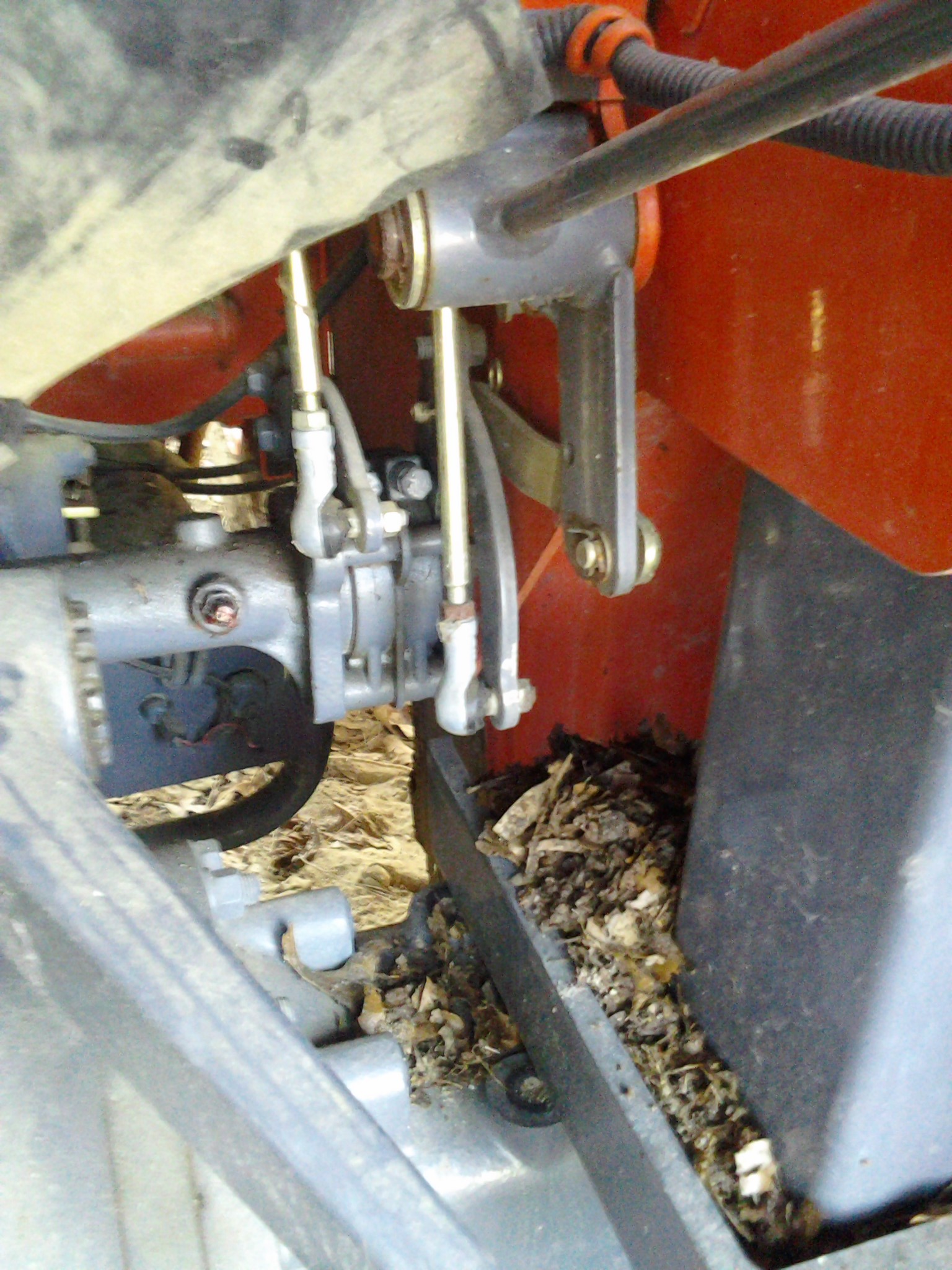

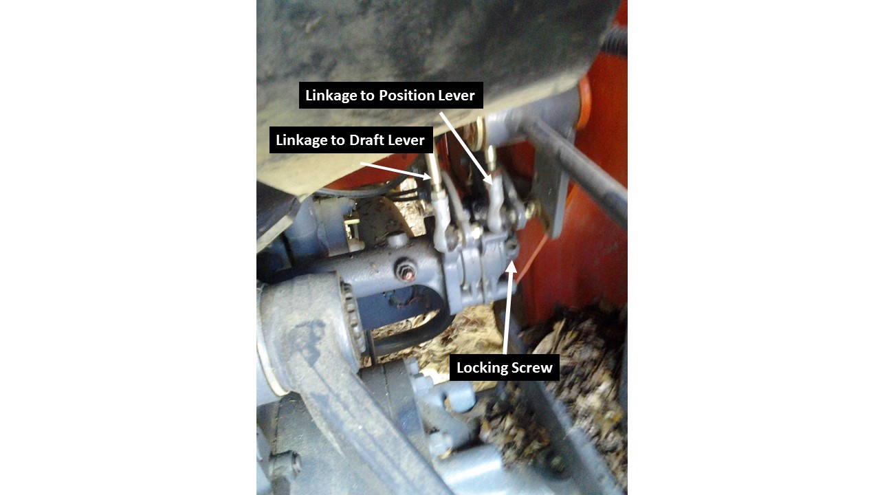

Just had my new-to-me DK45S delivered last Saturday and gave it a heck of a workout bringing down an old barn. I needed to hook my trailer to it and I like to use the 3 point hitch with a drawbar attached to connect. When I got the tractor, both the position and draft controls were pulled all the way back and the 3 point was raised. I lowered the position control lever but the 3 point arms did not respond. If I lowered the draft control lever the arms would lower, but pulling back on the Position control lever would not make them raise. It appears only the Draft control lever affects the 3 point arms at this point.
I could not find anything on the owners manual except in the Troubleshooting section that is the hydraulics do not lower to - Check the hydraulic adjusting grip. (whatever that is). Is there something simple at play here that is not obvious to this new Kioti owner, or do I need to call the seller to discuss?

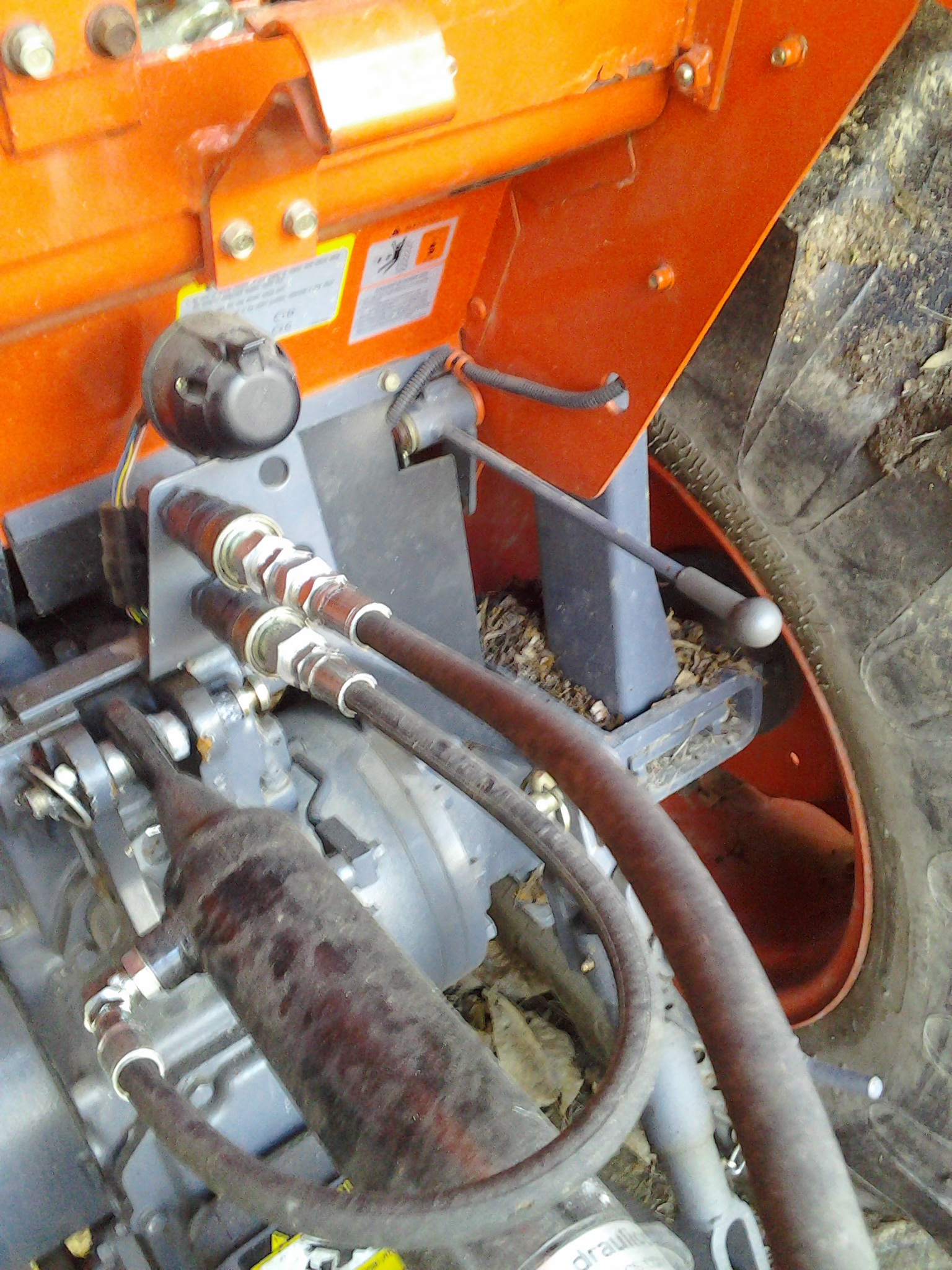

First, the small round shaft (with a spherical knob on the end) controls hydraulic flow to the remote quick-disconnects at the back. The fore and aft positions direct flow to one or the other QDs. But with nothing connected at the QDs, this "dead heads" the flow which puts a strain on the hydraulic pump. Prolonged operation with a deadheaded load will damage the hydraulic pump; you don't want to do that. When the remote is activated (fore or aft) it steals hydraulic power from the three-point hitch. Bottom line: keep that lever centered if you aren't using remote hydraulics and especially beware of it getting accidentally put in the detent position.

Not questioning ANY replies here - just posting an obvious point. The valve by the floor shows it is to change the speed of the 3 point lowering. I was able to bring the arms down using the draft lever (so the arms are now down), the draft lever is now at the bottom of the selector, and the 3 point arms did not respond to the position control lever at this point. Since the valve by the floor only affects the speed to LOWER the arms, I can't see how it would keep it from RAISING the arms(?) Also, since the draft lever was at the bottom position, according to your replies that should make the Position lever take control if I am reading your replies correctly - and this did not happen.
Am I missing something?
Also - the rear hydraulic controls appeared to me to be in the middle of the selector range.

Murph - I did this. Once the arms lowered using the draft control lever (they will move up and down all day long with the draft control lever), and with the draft control lever in the DOWN position - the position control lever still did not move the 3 point arms at any point along the range selector slot.
