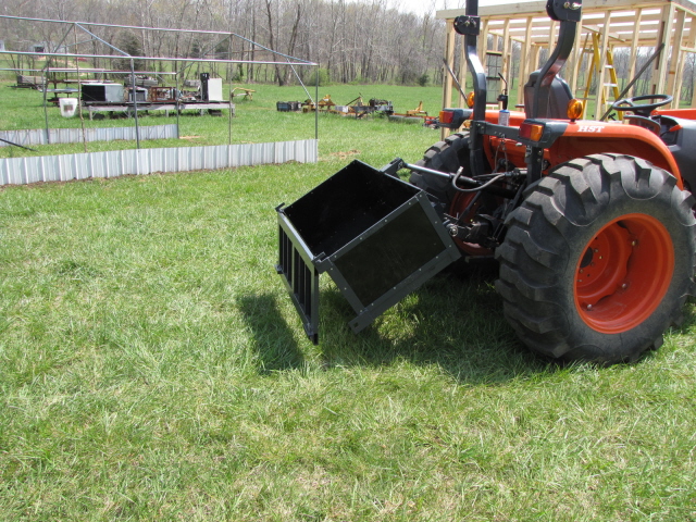

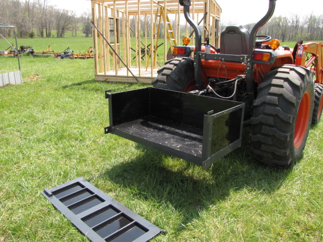

Here is my do all dump box. Can't add anything more, only that you well like one. Sure can do alot with one.

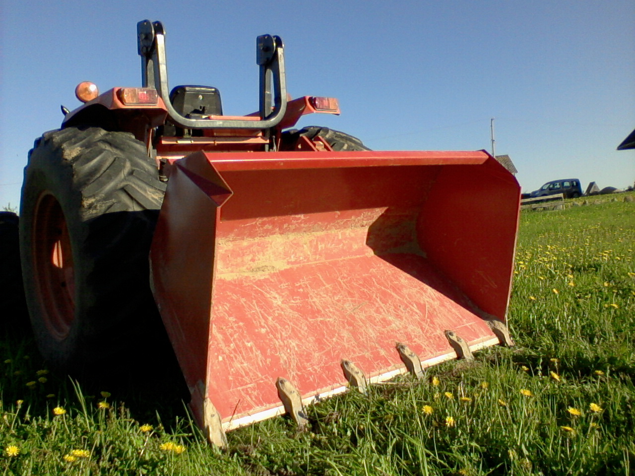

That my attachment unlikely is a 3ph dump BOX. This is more like 3ph dump BUCKET. :confused3:
OK, whatever it is, it has no cylinder, but kinematically operated. And I can't live without it. :thumbsup:

I have one and like it a lot. (see photo) It essentially turns your tractor into a small pickup truck for off-road uses. These "Tipping Transport Boxes" are common in Europe and other parts of the world. As others have mentioned, the hitch points are close to the ground, so you have to either place blocks or a pallet underneath when it is disconnected or you have to extend the lift links on the 3 point hitch. But there is a good reason the points are close to the ground--to allow ground clearance for the box to dump when it is fully raised. With the tailgate removed you can just back into a pile of loose material such as gravel, mulch, snow, etc. to load the box. Then after dumping, you lower the box to the ground and the latch automatically reengages. You have to determine if the lift capacity of your tractor 3-point hitch is sufficient for the loads you want to carry. But the most important consideration is that you need to have adequate FRONT counterbalance weight such as a loader on your tractor. Without front weight on the tractor, the front wheels may not have enough downforce to be able to steer.

That's true. To set off a bucket I'm using a ballast adapted from unknown tractor at the front. Total weight of ballast is 250 kg (550 lbs). Empty bucket weights 210 kg (462 lbs).
