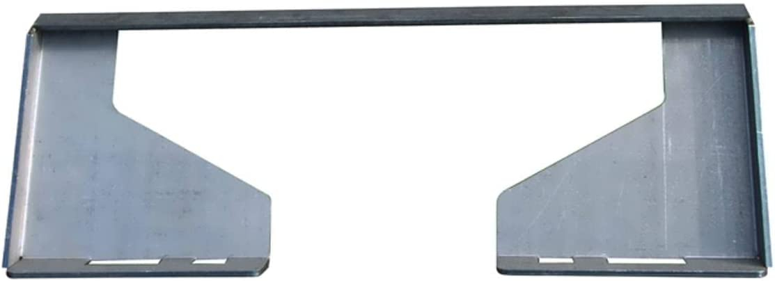

I have found out I can't get a new bucket for 4 months, so I need to adapt the old one. I am getting the ATI Tach-All from Amazon because no one else could get me at an acceptable price within the time I'm willing to wait. Amazon also has a lot of plates, and I can get a 3/8" Titan for $149.
I am wondering if the Titan will be a good choice. Tractor Mike sells a plate for Kubota buckets, and it's different. It has two rectangular panels at the ends with a big rectangular cutout in the middle. Kubota buckets have angle-iron horizontal supports along the back, so you have to cut the ends of them, and the cutouts on the Tractor Mike plate allow you to leave a lot of angle iron. The Titan plate has larger panels on the ends, so in order to save more of the angle iron, I would have to cut some steel out.
Titan plate:
Link to Tractor Mike plate: Tractor Loader Quick Attach Conversion Kits - Ask Tractor Mike
   / Quality of Wicked Buckets? Market for Used Non-SSQA Buckets? #20
A plate that fits the ATI-Tach All is what you need if you decide to buy a plate instead of welding up your own. There are standard dimensions for non-proprietary QA mounts.
Although the plate has standard dimensions, the backs of Kubota buckets apparently vary. Suggest you post a picture of the back of yours and perhaps we can discuss how you might adapt yours. It might be possible to just weld up the necessary metal on the back of your bucket.
