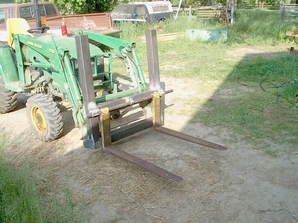

I have a 60" quick attach loader with bolt-on cutting edge (Kubota). The quick attach pallet fork rig runs between $500-$700 depending on manufacturer. The alternative is to weld up a pair of DIY clamp-on forks as pictured. These were made for a BX22 loader using heavy gauge channel steel, cost was less than $50 in scrap metal.
So purely on cost the DIY approach is the obvious choice. However, I have heard stories the clamp-ons can cause the bucket edge to bow. Has anyone had this problem with a reinforced cutting edge bucket using the clamp-ons?

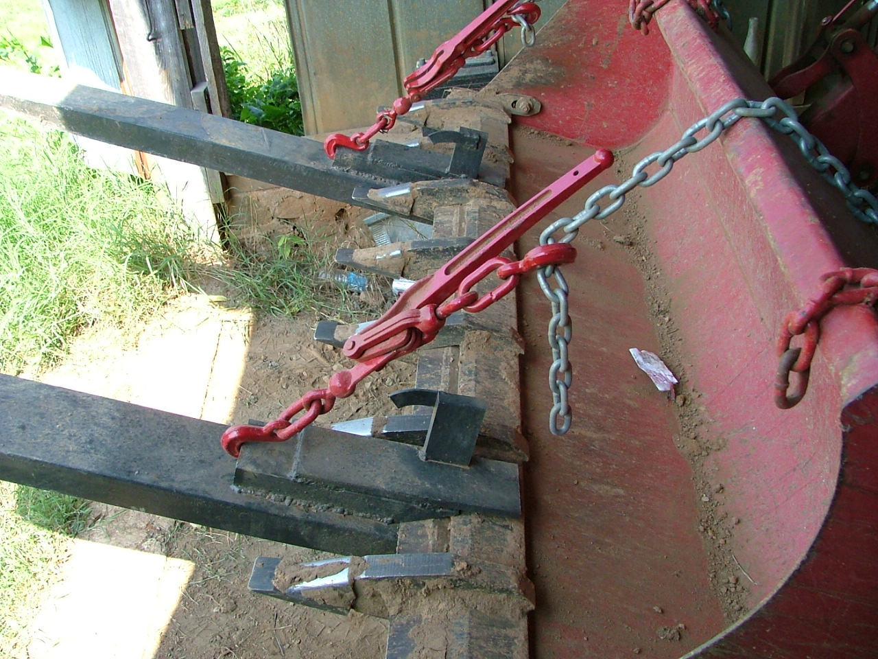

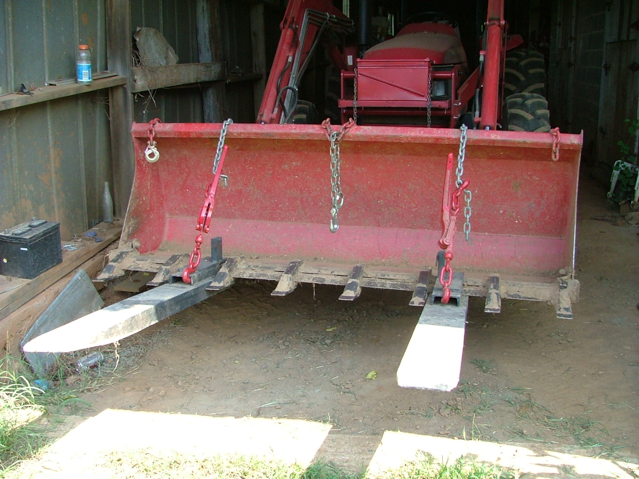

When I built mine, I did the chain/dog version over the top of the bucket. I've got a toothbar and had to angle some flat steel so that it would fit/hold. The loader will pick up a ton and a half so I needed a pretty sturdy set up. I'm of the opinion that the chain spreads the weight over the entire bucket rather than the leading edge of the bucket. If you're not gonna pick up more than a couple hundred lbs, I wouldn't worry about it though. BobG in VA

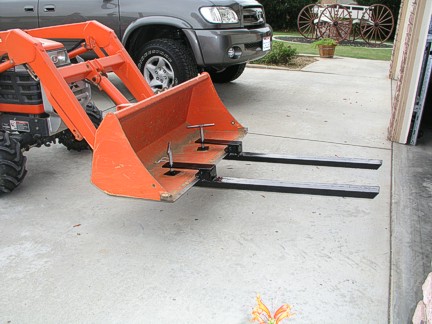

Theres a fellow on ebay that sells the skid steer QA plate for $85 + shipping. If I started with this plate, I could fab fab the necessary structure to attach the forks to the plate. Sort of along the lines as the one in the pic.

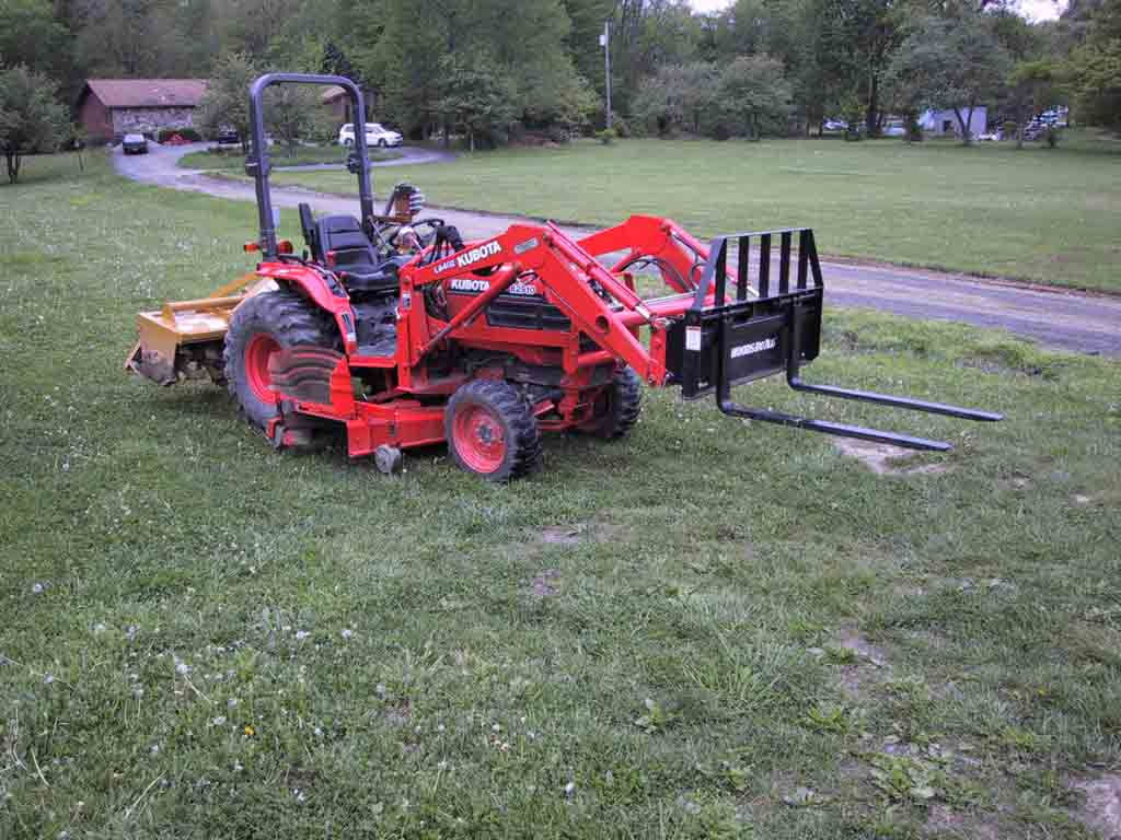

my forks
