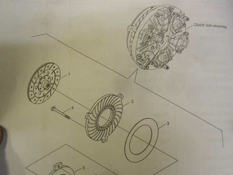

Aside from the stuck clutch plate, it may be that the PTO clutch or "Auxiliary clutch" as the manual calls it, hasn't got it's separator levers correctly adjusted.
I'm guessing a photo of the clutch exploded diagram and parts list would be useful to you at this point... want me to post a picture, or have you ordered manuals?

An exploded view of the assembly would be useful if there was some way I could free the clutch without dismantling the tractor otherwise probably not.

I've now taken photos, and you'll find them here.
Confusion appears to have arisen because what BlueChip was calling "fingers" are called "clutch separate levers" ( in the manual they're parts 17 and 19 on clutch assy 2), and what I was calling "fingers" were the fingers that stick off the "clutch fork". (part 8 in Clutch assy 1)
All I can do that is slightly helpful is post the pictures.... :)

Photo of clutch through windows
I rotated the clutch around a bit but don't think the access provides much insight into the issue of PTO clutch release.
The front inspection window is small and also only seems to show the ring-gear.

The small window is where you find the timing marks. It can also come in handy to lever the flywheel around.
First thing you're looking for in the other window is the gap between the clutch fingers and the throwout bearing. But I can't quite tell from your photos whether you have a six finger or three finger clutch (they're not adjusted the same). I'm thinkin' six, but I gotta be sure.

You guys DID see and provided a link right?
Here's one of them.
The rest - just in case you missed it - you'll find the diagrams and BOM at near the end of this album.
But you know... nice that you found it somewhere else...
Thanks Nick and Greg,
I rotated the clutch and it shows six (what are listed as) "separate lever". The disc which is itemised as a "clutch cover" has three slots (a bit different from the drawing). These slots appear to be the full thickness of the disc.
