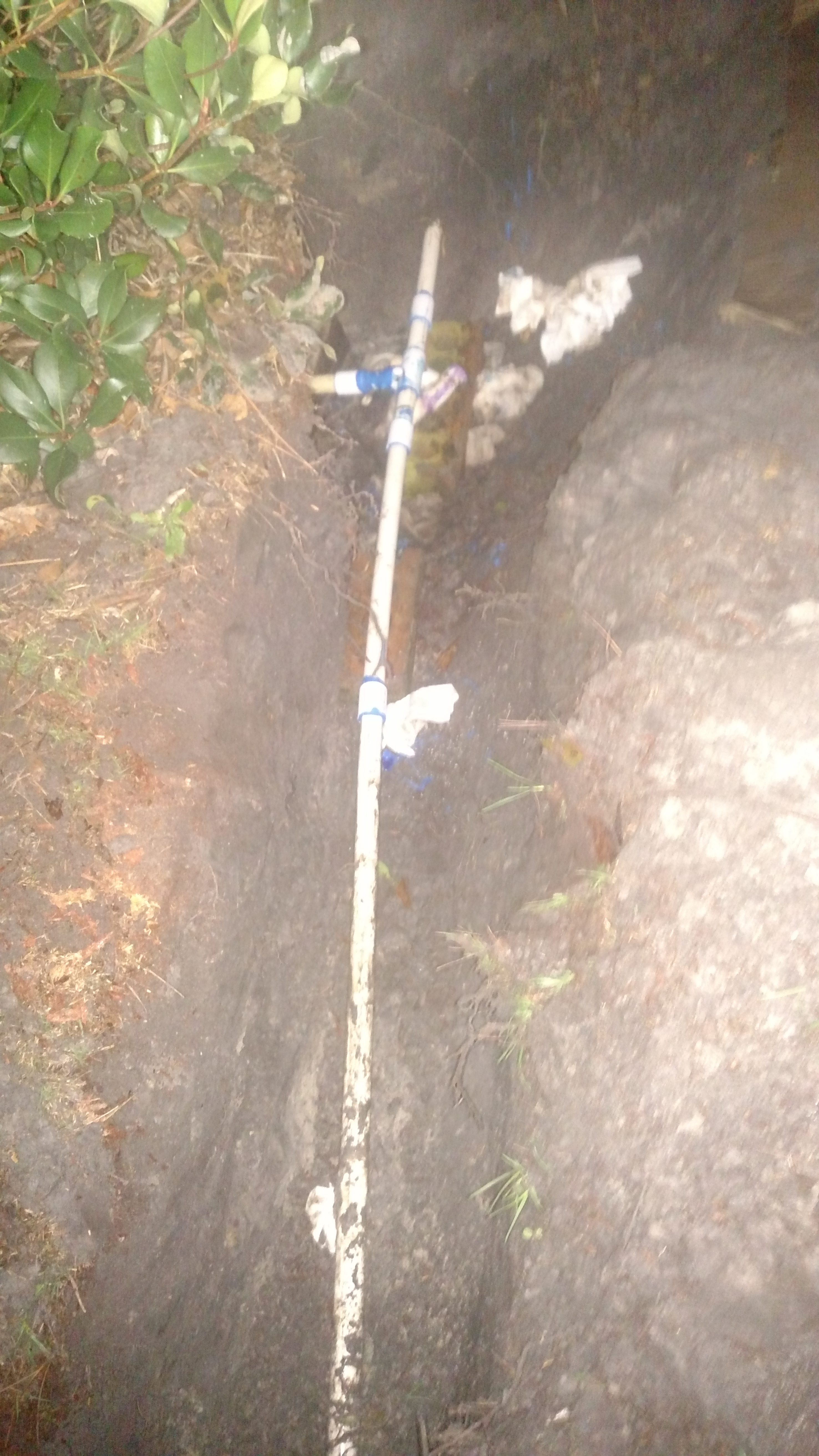

The 3 water lines come in at 3 different angles not even close to 90° and heights, I didn't install the pipe or plant the shrubs around them.
Original owner installed a 90 for the water supply and second owner added a T for a spigot in front yard...which is the pipe in top of pic..
And planted all the shrubs...
It was a wonderful afternoon fixing that mess!
Braced up pipe with bricks/blocks at stress points.
Glued at waited for each joint to set at stress points before moving to next.
Almost brought out the heat gun on them but didn't want to make a bigger mess..
I might just be the one to put the chainsaw on them now.. and coat the stumps with 2-4-D afterwards...
I found roots wrapped all around the pipes in several places...
Those shrubs are on death row!

What did/do these pipes go to? Lawn sprinkler?
I for one wouldn't want buried PVC pipe for my link to the well...black poly for me!
   / PVC Water Line Pulled Loose At T-Joint/Shrubs Might Go Away !!!
The sloppy install of the first tee and the roots that were wrapped around the pipes... Is most likely the cause of the failure.
With the way it's braced up now I hopefully won't see another failure...
I can thank another family member who lived here before me for the sloppy install and all the shrubbery planted on top of both water lines

From the picture, it looks like you used Blue Glue on your joints. If that's true, you will be doing this again. Blue Glue is OK for drain lines, but it's not very good for lines under pressure.
PVC needs to have a two part treatment to weld the joints together. Purple primer reacts to the PVC and softens it. Then Clear Cement is used to melt the fitting to the pipe. Both pieces will melt together, forming a solid weld that is stronger then just the pipe or the fitting. When this is done, the fitting will break apart before the pipe slides out of it.
Oatly sells a two piece set with the Purple Primer and Medium Duty Clear Cement that is good for sprinklers. Always buy new when doing a project. The Cement will thicken over time and not work properly if it's old. The Purple Primer will separate over time and become clear looking when it's no longer any good. It's not worth the risk of failure to use old cans of either. For me, it's it's been a few months, that's too old, and I buy brand new.
For water lines going to, and inside a building, the spend the extra money for the Heavy Duty Clear Cement.
