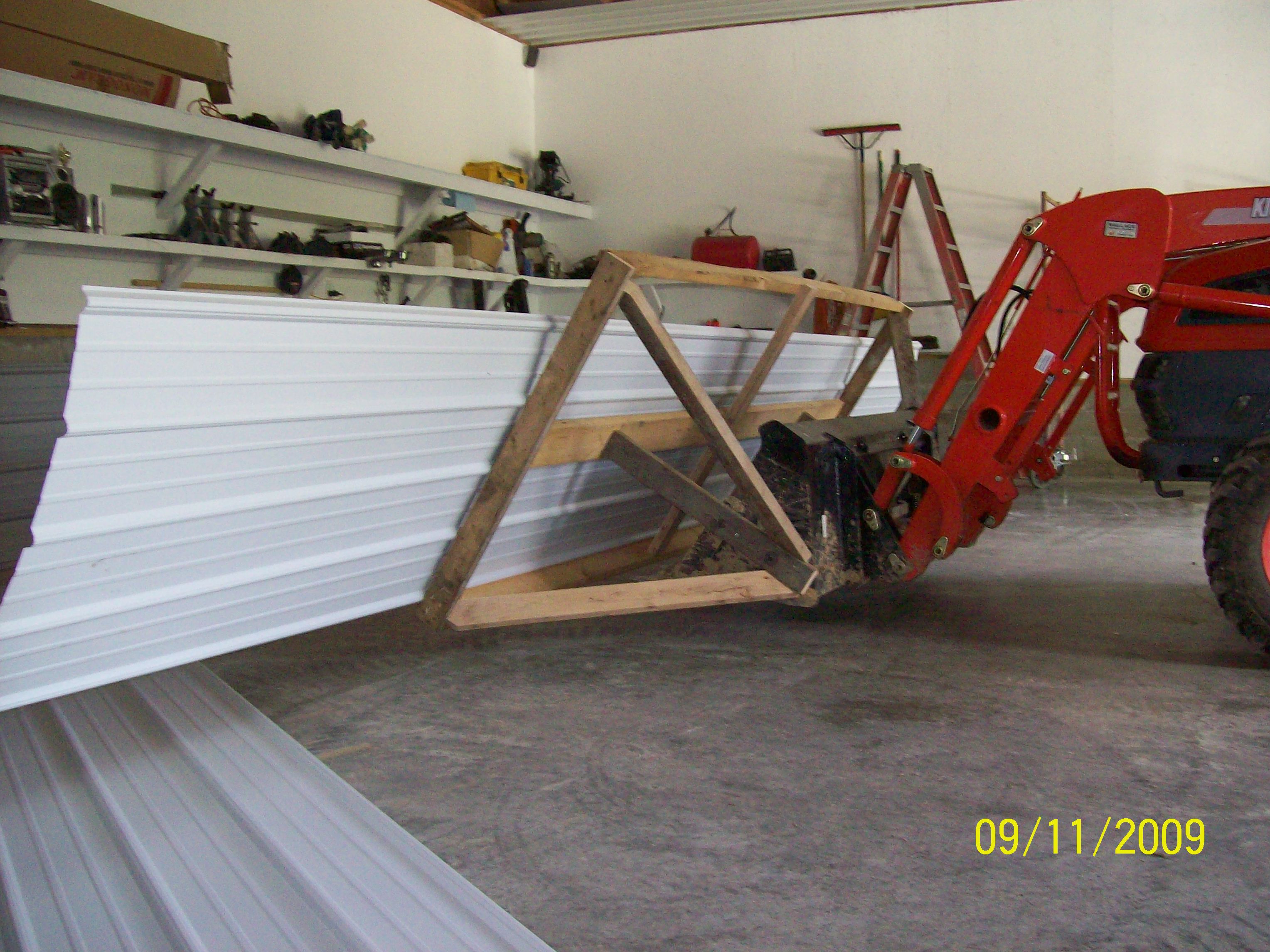

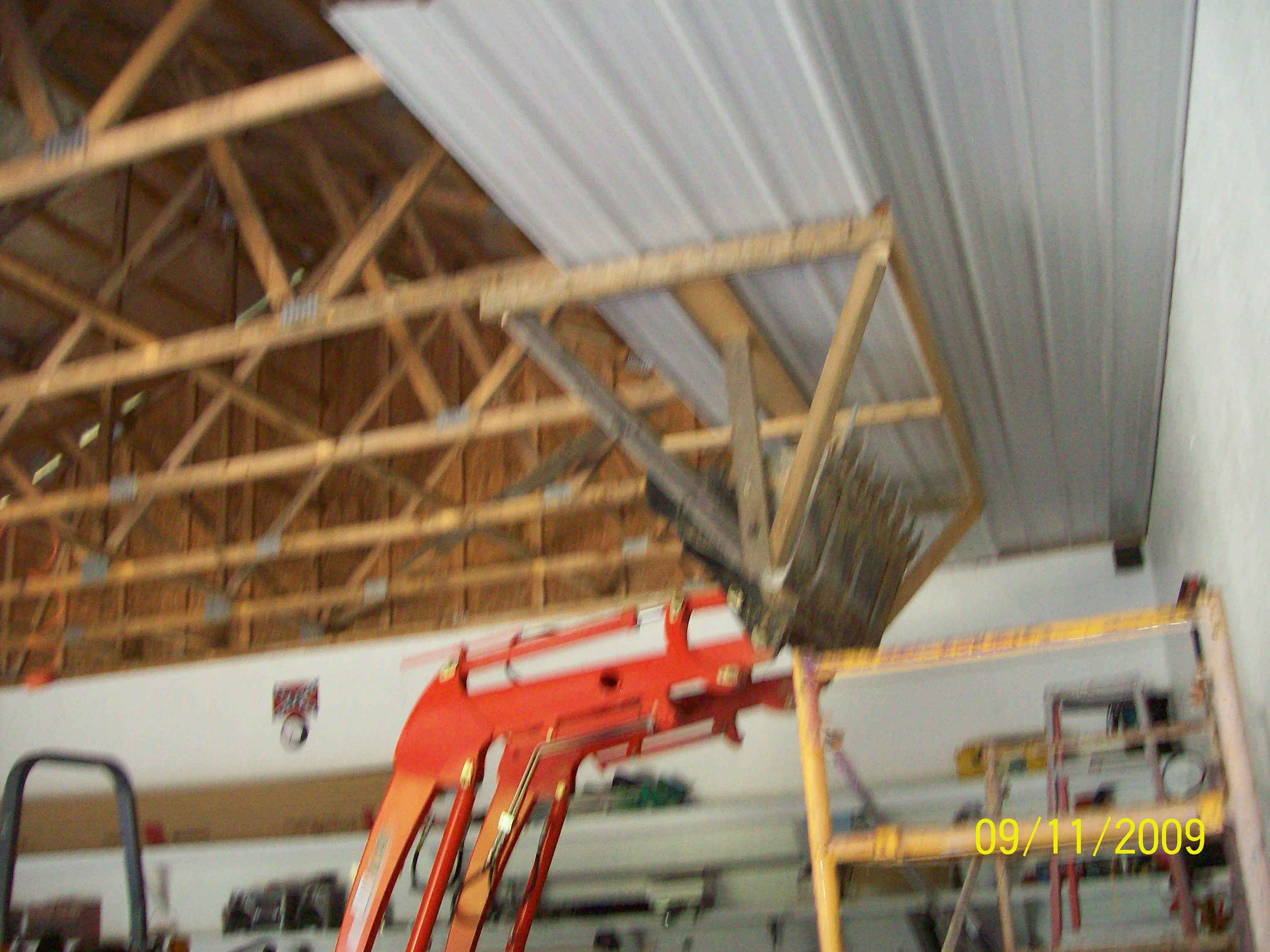

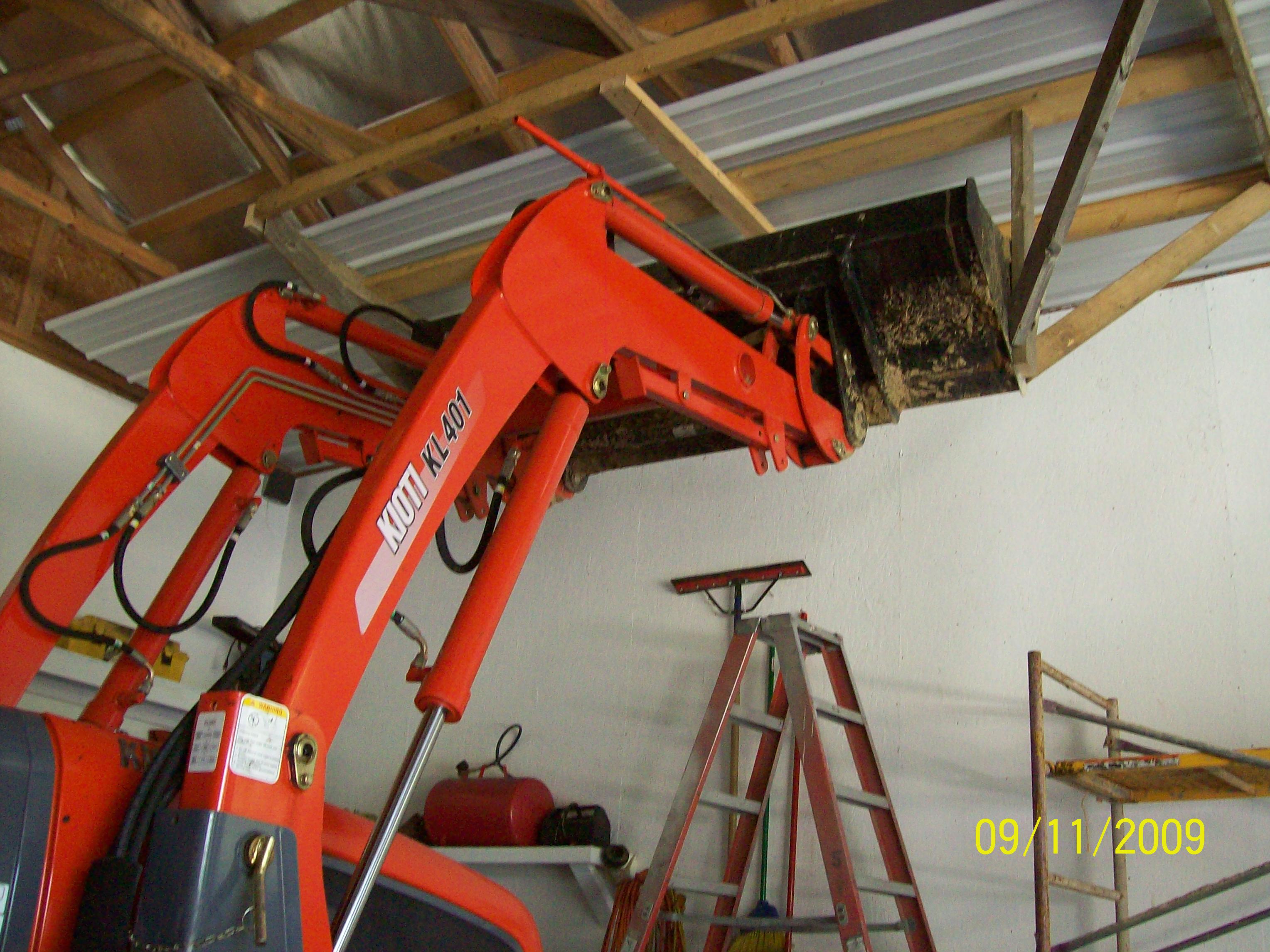

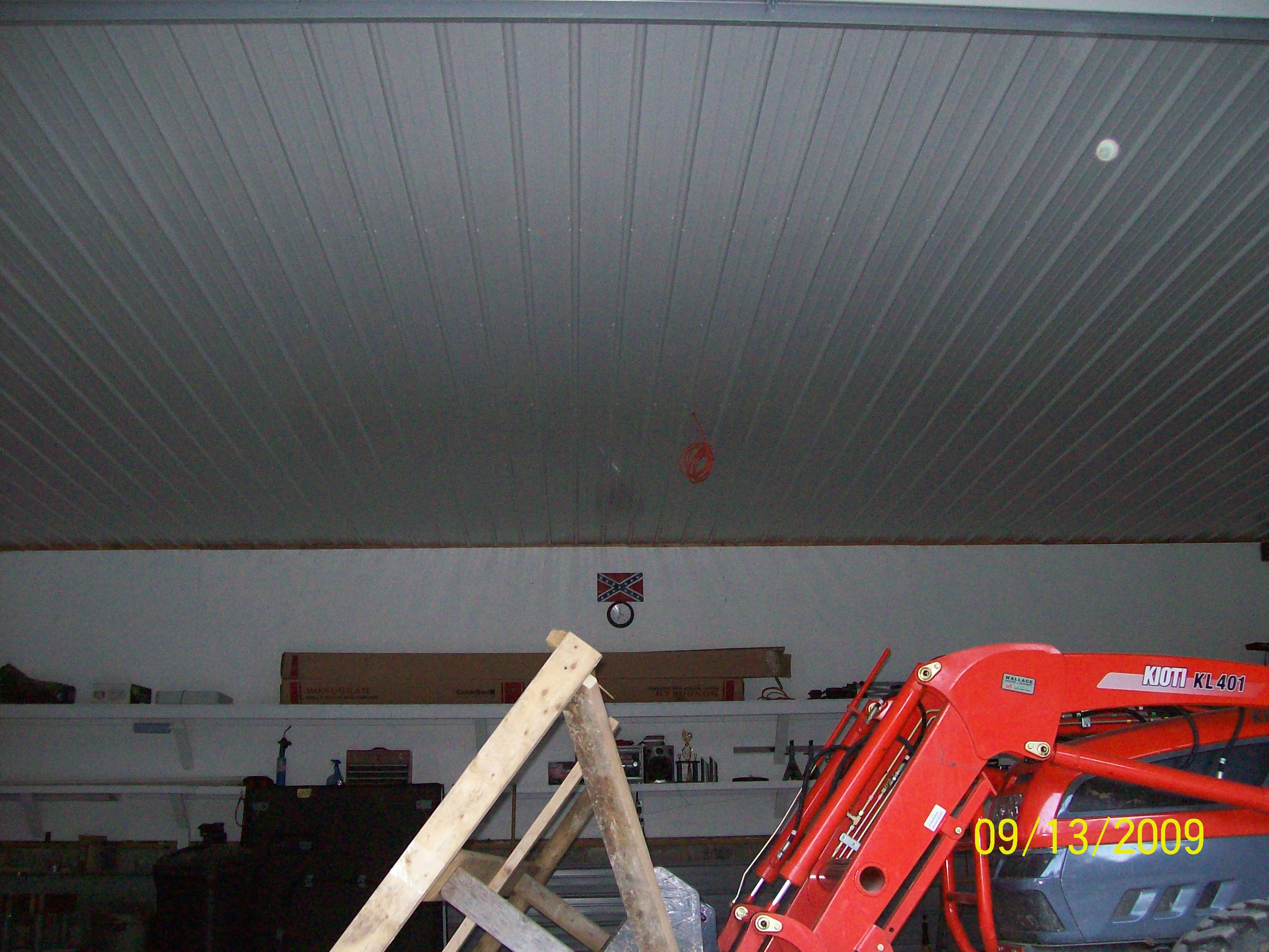

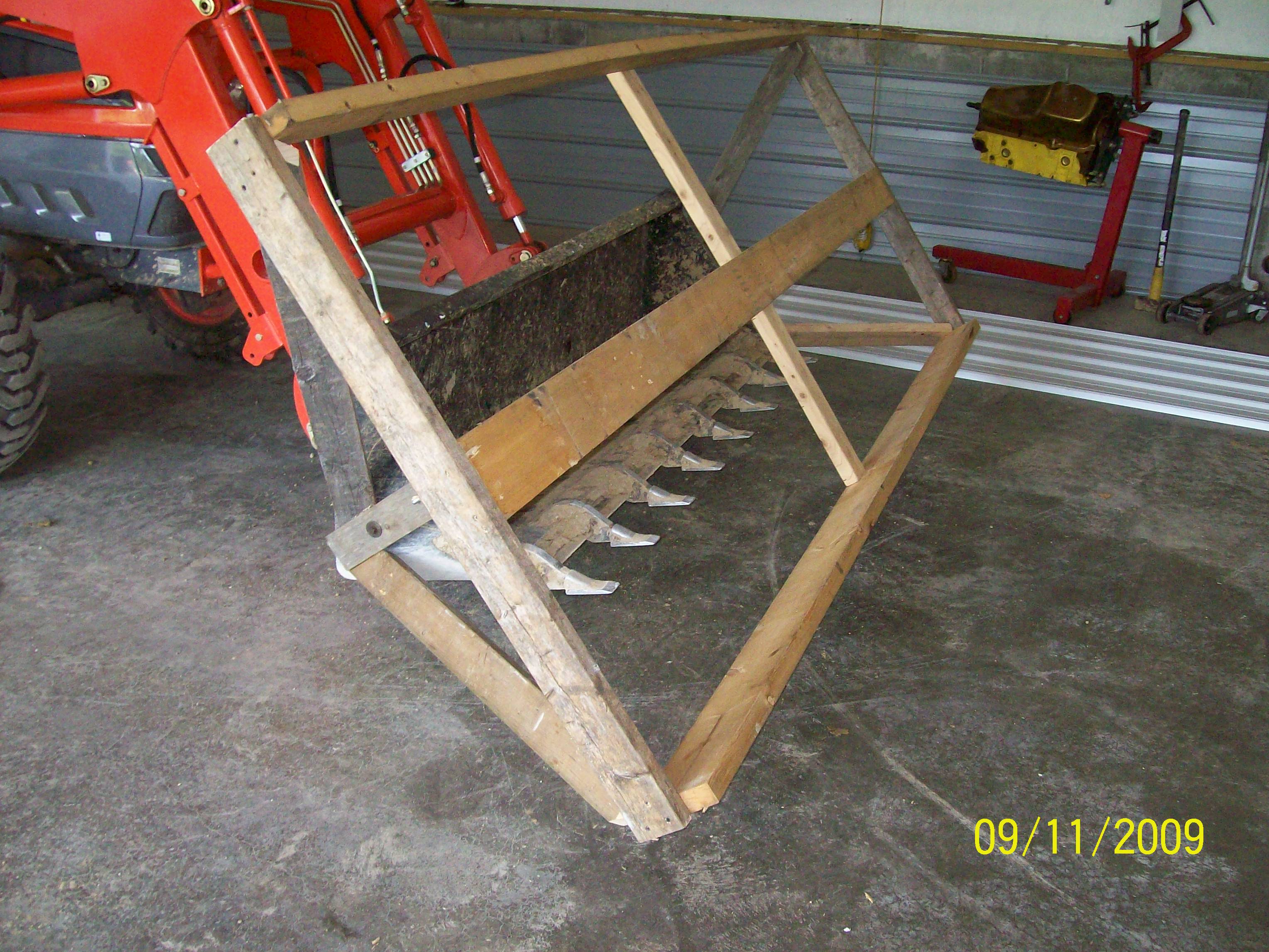

Here are some pics of my weekend project:
I bolted a 10ft wide frame built out of lumber to my tractor bucket (the holes were in the bucket from the factory) and used it as a platform to lift 20ft and 16ft sheets of metal to the trusses which are 12ft high. and 4ft O/C.
It worked out great and I was able to get it all done in most of last weekend by myself.
I'm gonna blow about a foot or so of insulation on top of the metal. I framed the walls with 2x6's and used r19 in them and I think it should heat pretty easy this winter. I'm gonna heat it with a wood boiler:D

Carpenter,
Excellent example of what can be accomplished in a weekend by a clever man and a versatile tool.
With 4' O/C truss spacing, do you have any concerns about undesirable deflections of the ceiling under the load of 12" of blown insulation?
