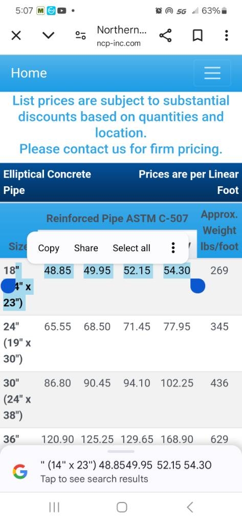

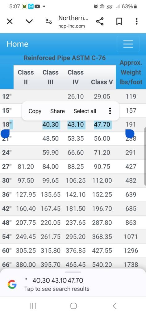

   / Putting in a gravel driveway #77
So, sample section of 1; $40/lf for 18" RCP vs $48/LF for 14x23 ERCP.
Also, note, this manufacters 18" equivalent is 14x23; some others are 14x22; that's what I meant about it being harder to mix/match

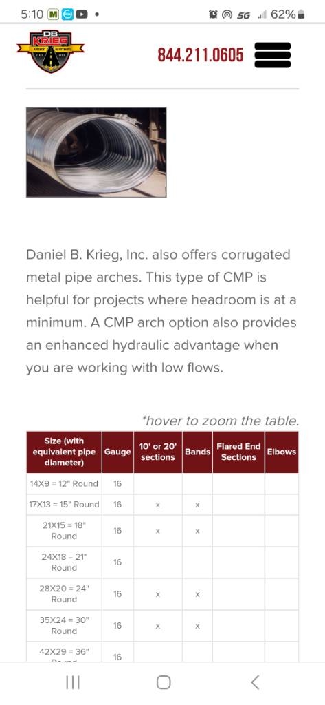

I found a manufacter of corrugated metal pipe arch in Penn. No idea on prices, and I have personally never seen this used down here
