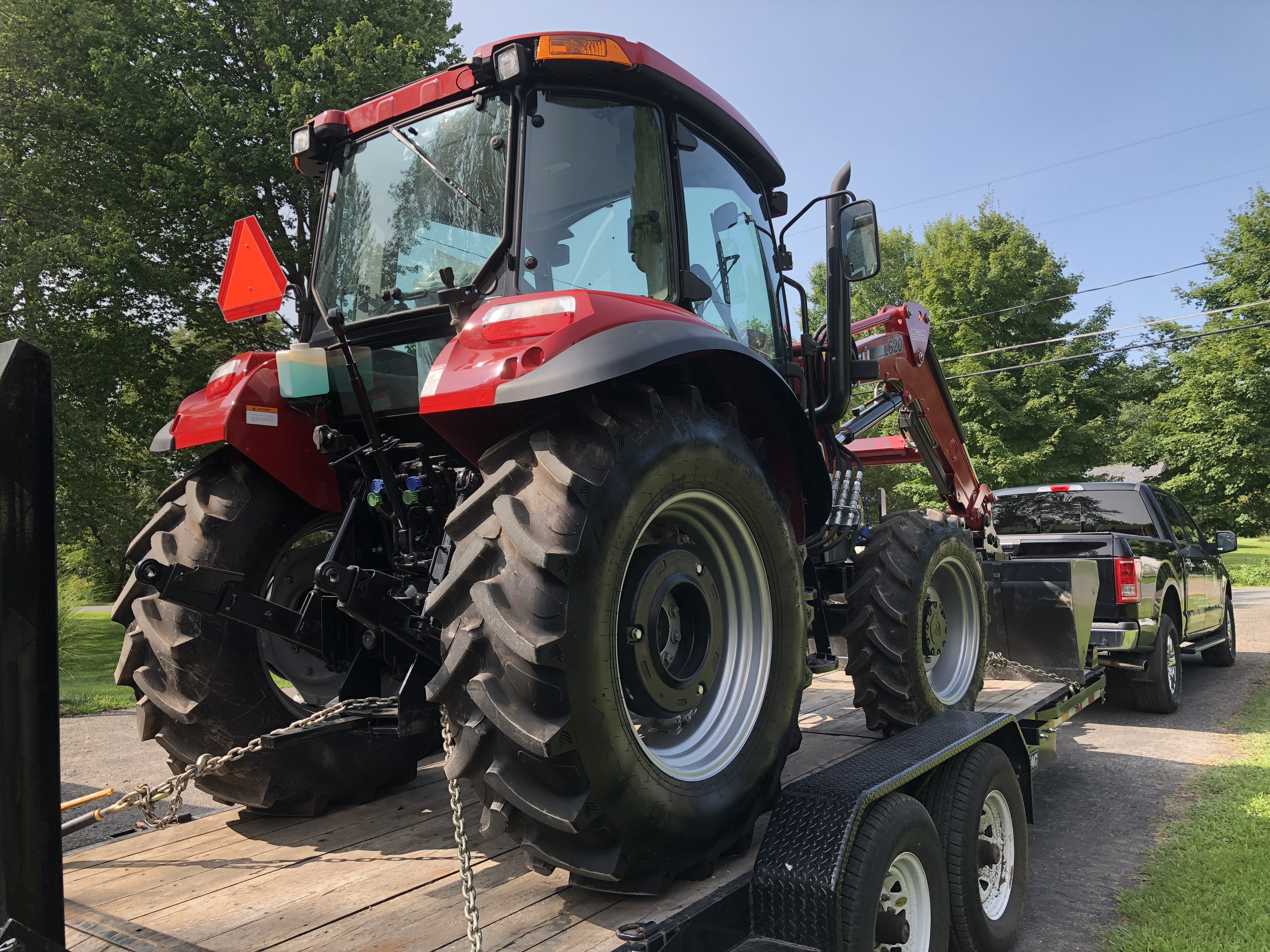

The tractor came in yesterday. It is a left over 2017. Does anyone know of the differences from 17-18? I noticed the radio which is not blue tooth. The rear wiper has a hideous switch on the wiper motor. Dealer will wire it to switch on pillar. No sun roof. This could be good or bad. To me everything else looked the same but what am I missing? Thanks
Take a look at my posts on our T4.75, I added a blue tooth adapter and upgraded our speakers, I also added the switch for
the rear wiper in the pillar. I have links in the post for the parts if they help.

We are doing the wiper on the pillar fix. I will probably get the tractor in the next couple of days. I will be bringing it back to get everything done when the parts come in. Probably just fill the rear tires for now and get it heading my direction.
   / Put offer on Case 75C. Why so few Case tractors sold
#46

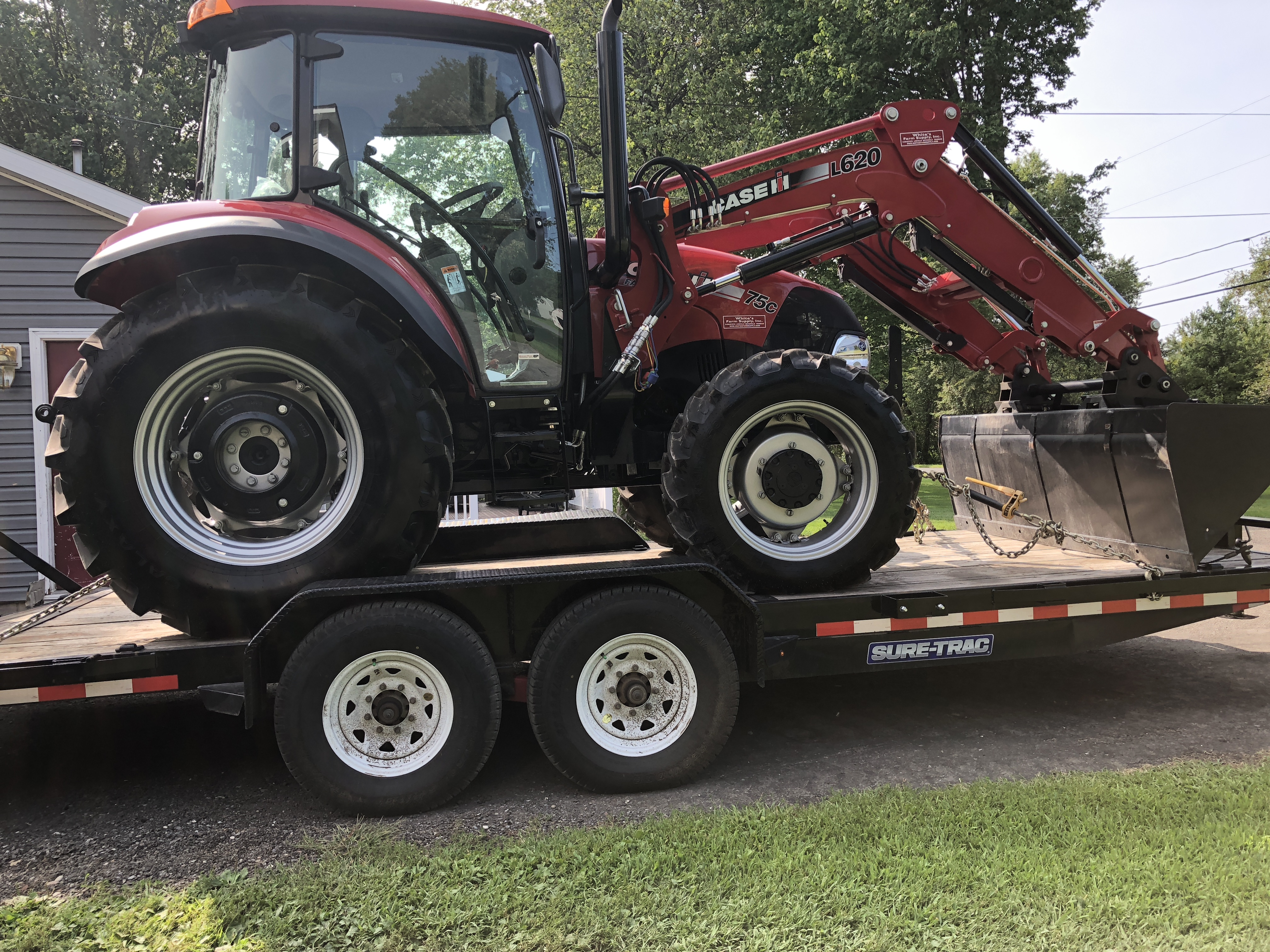

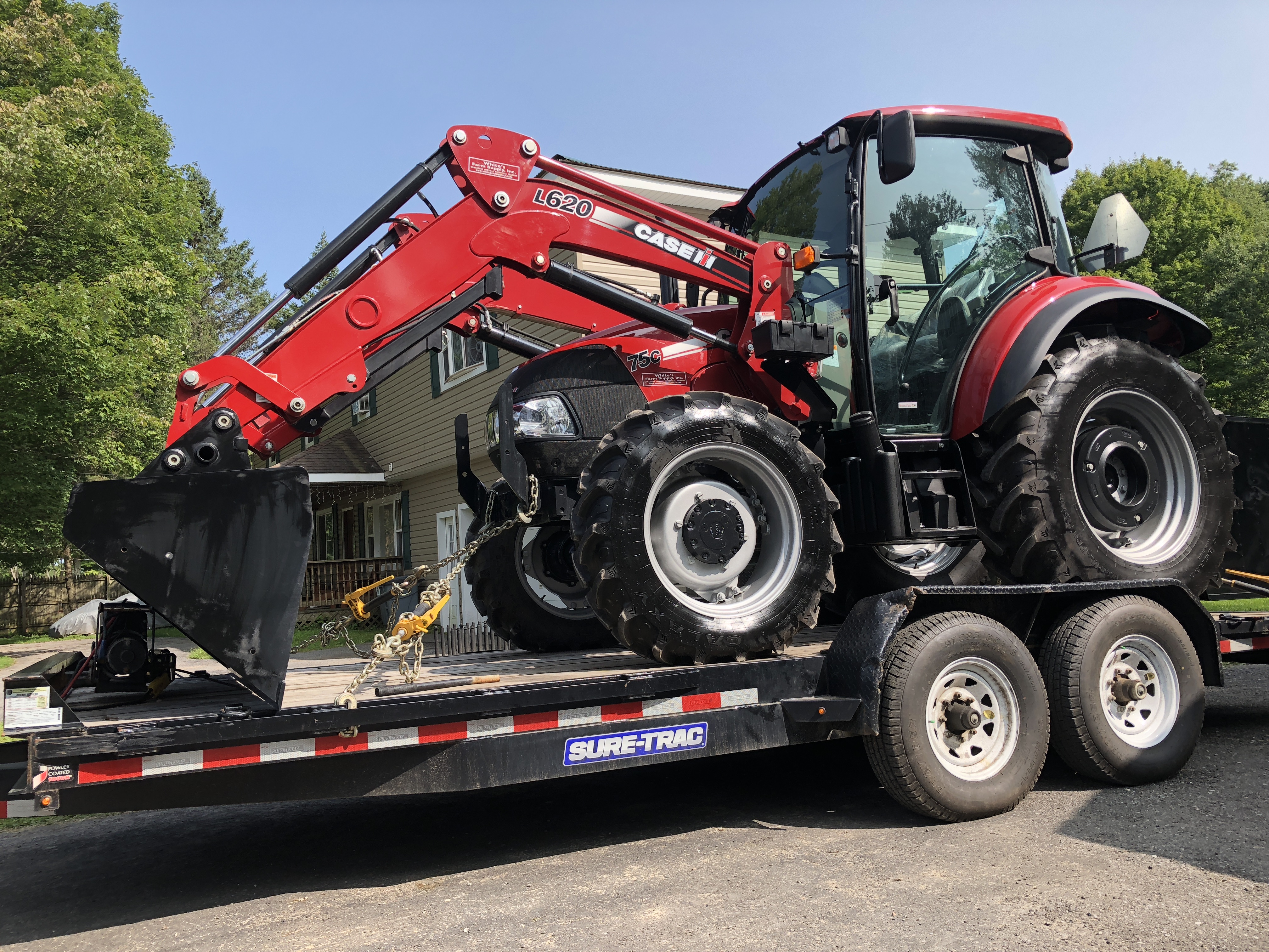

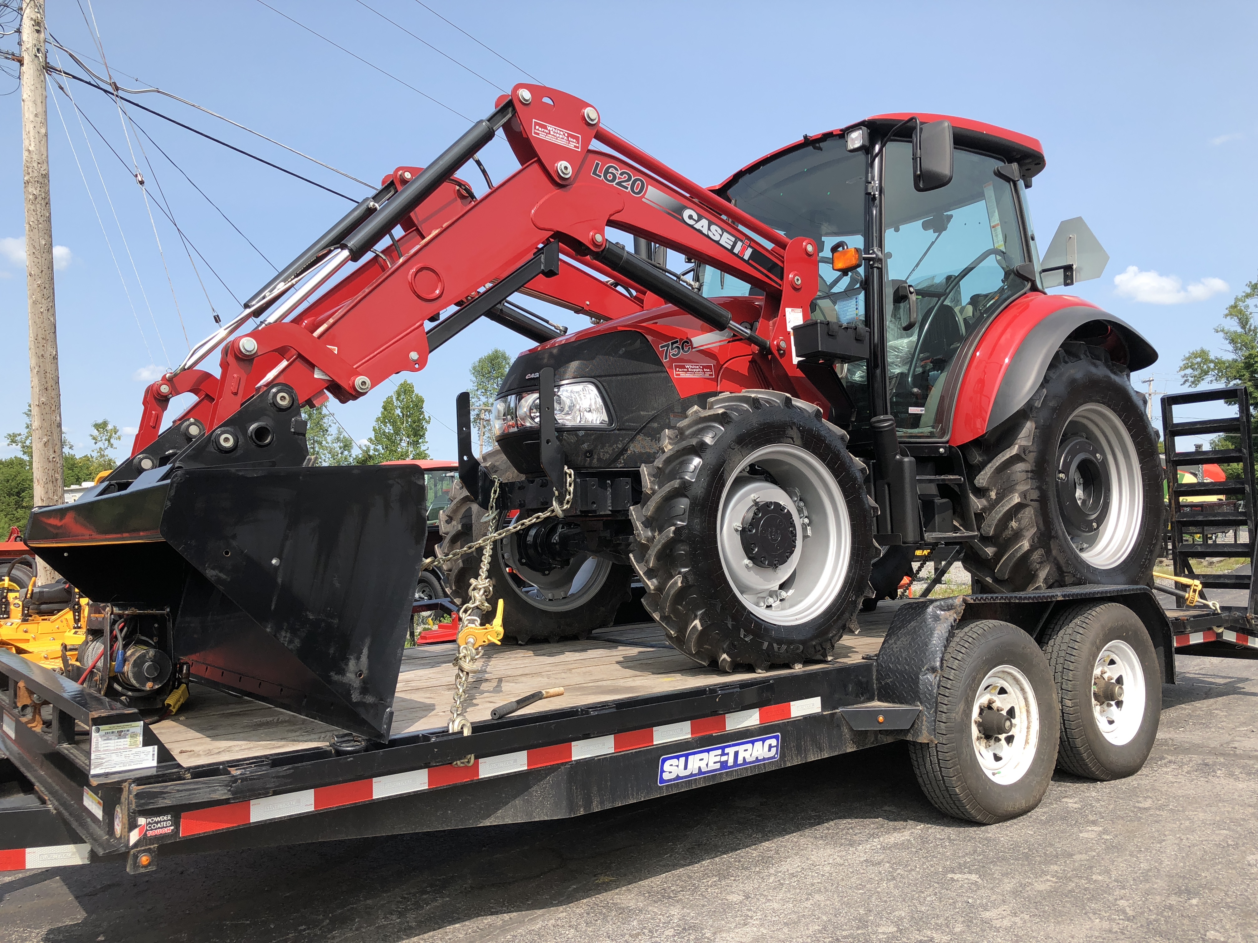

Got the new tractor yesterday. First time driving a power shift. Different. Goes back in a month to get many add ons done to it. Loaded rear tires she still gets light. Very comfortable cab. So far so good but only put an hour on it :)
