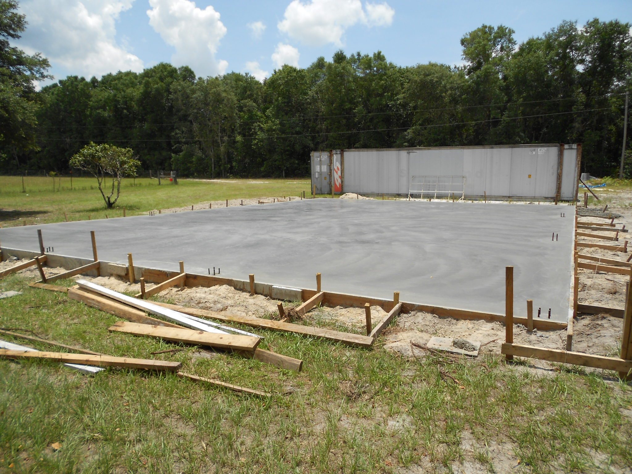

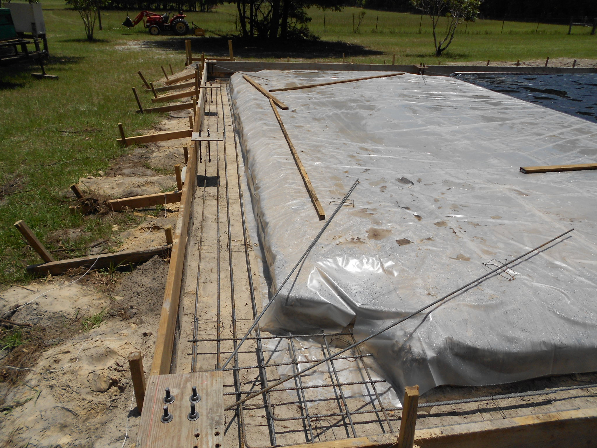

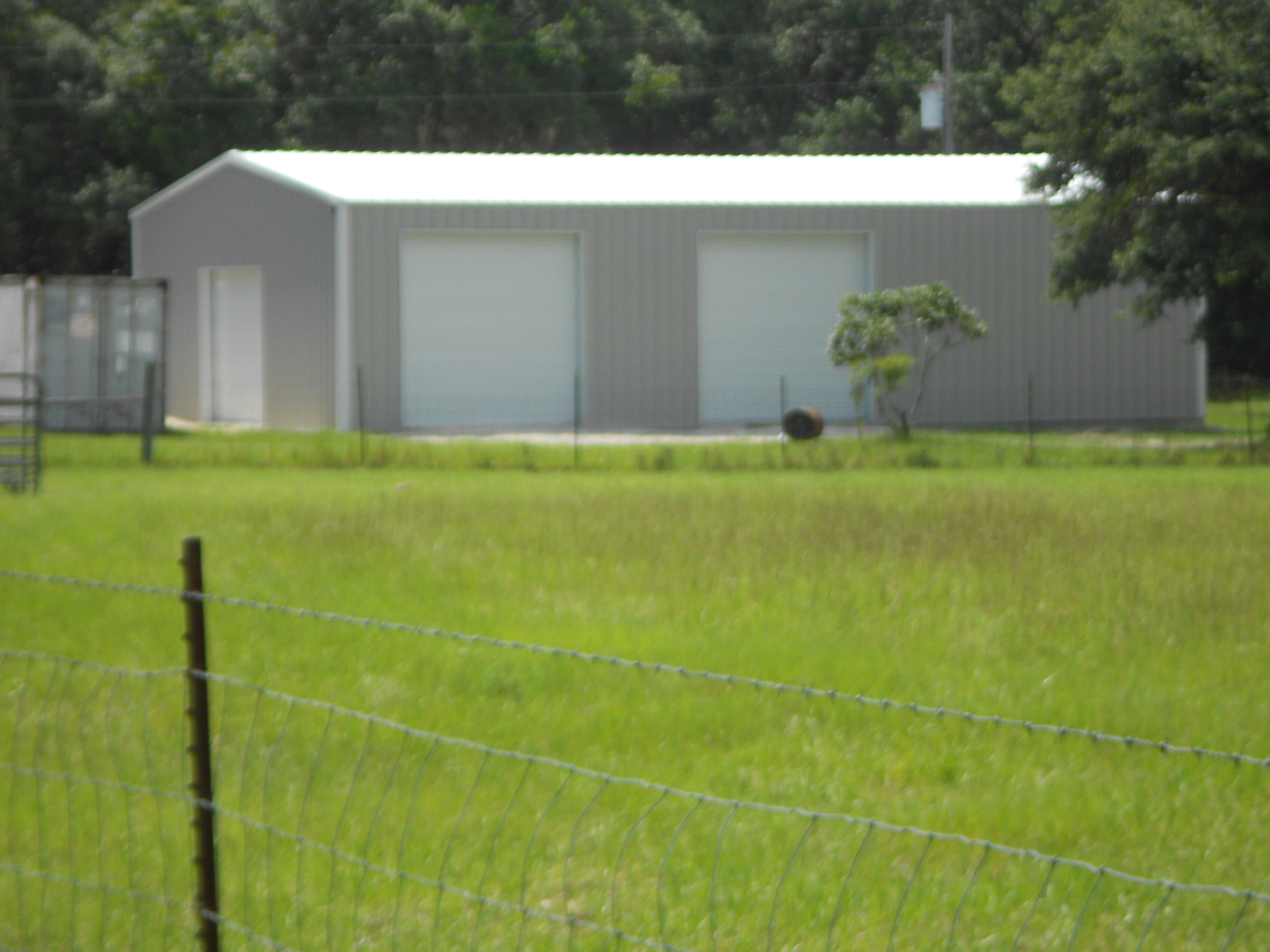

I would tell them to stick the fiber where the sun doesn't shine!
I had a 40' X 65' slab poured 15 years ago and they bragged that with fiber I didn't need re-bar or road mesh.
I can show places where the concrete has cracked and heaved over 1" and the ground was compacted.
Pics are of slab and 40' X 60' X 14' building I had put up in May. Concrete guys were FIRST CLASS! Slab is perfect, I have done concrete work and have even driven the trucks.
Pic was taken before they added mesh placed on chairs then poured.

If your slab heaved over an inch , you have either a subgrade or drainage problem.
Fiber is great for stopping cracks in thin concrete slabs

I was thinking the same thing, about heaving or settlement.
Fiber is for controlling cracks from curing, which should be minimal if you cut with in 24 hours of pour, and don't soup it up with too much extra water
