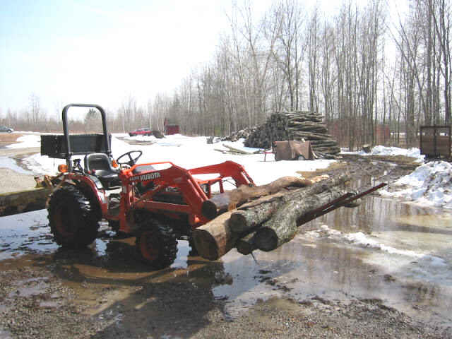

I have 30 acres and I use a B7500 at 21 hp. These are smaller but very impressive in the amount of work they can do.
I do these chores with it:
Brush hog trails through my woods, made many new trails
Plow snow
rototill
boompole to pick items up
receiver hitch to move and tow trailers including moving a trailer with a full cord of wood (soft ground tires were sunk in about 6 inches.)
Skid logs
Moved rocks
FEL to move dirt
landscape rake and box blade
I'll give you some picture.
   / Purchasing new tractor but which one? #14
Here I'm moving forty feet of oak logs at one time. With some home built bucket forks.
