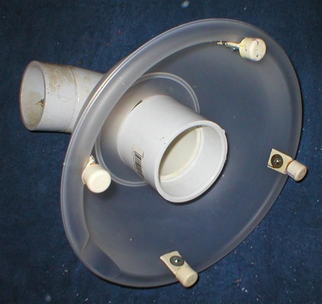

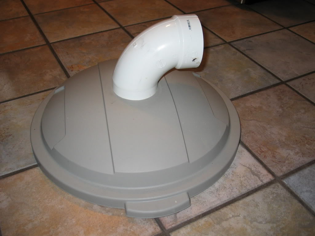

have a couple ideas. but for you going to suggest....
making something out of PVC pipe. + 55 gallon trash can lid or round snow sled / saucer + some concrete, + maybe some hardboard insulation that comes in 1/4" to 2" thick 8' x 4' sheets. + toilet flange 3" or 4",
build your self a "sled" with some pvc pipe as skies, say 1.5" to 2" pipe. this is so you can physically push/pull a sled across mud, and into water. in the bottom 2" pvc pipes / skies, dump some concrete into them. so it weighs things down. (you want bottom heavy)
--concrete is there to help keep it up right, but also to help keep the bottom under water. all plastic pipe loves to float, even when it has water in it.
you are going to want the anti air sucking device (snow slow / trash can lid) to be approx 3 to 6" above the mud. and the toilet flange is used to connect your pipe/hose to the trash can lid/snow sled. attach the toilet flange in the center. and then come off the toliet flange with a 90 degree fitting. then attach to your pipe/hose.
your going to need a lot of rope/cable. something. most likely min of 2 ropes. to physically attach to the sled, then walk around the perimeter of the puddle. and then pull the sled into place. the 2nd rope most likely used to help keep things from flipping upside down on you, or to correct an upside down retro fit bottom drain. (bottom heavy with concrete in the pvc skies, is to help keep things right side up)
going to suggest 1/2" thick 4 feet x 4 feet sheet plywood. as structural base.
--using TWO 2" shower drains, TWO 90 fittings per ski (all local hardware stores carry this) to attach 2 skies made out of 2" pvc pipe. to the plywood
--cut out center of plywood for trash can lid/round snow sled.
--run some bolts / washers/nuts between plywood and the trash can lid/ round snow sled. just drill and use washers around the edges of the trash can lid/snow sled. to keep it held firmly in place. does not need to be "water tight" plywood most likely only last for 1 year as is.
-- toss on some U bolts. with some extra washers. in a couple spots, to fasten your min 2 ropes/cables to. to pull sled out into the puddle
-- toss on a couple extra U bolts. and use zip ties or something, to strap the pipe/hose to the plywood. something to help keep from pulling the toilet flange out of the trash can lid/snow sled. perhaps some 2x4's, and building a H frame. or something to better support and hold onto the pipe. there numerous 3" and 4" metal braces/straps you can pick up at local hardware stores. that might work as well.
optional to sled
--toss on a couple inches of hard board insulation to the top of the plywood. so it floats a little. bit. and easier to pull across puddle. as long as the anti suction air device (trash can lid/round snow sled) is pointed down and edges are under water. you are good to go. the plywood and hardboard insulation can be above or below water. just the outside edge of the anti suction air device. needs to be in contact and/or below water. to keep from sucking air.
--and yes a dome shape like a trash can lid or round snow sled. is more preferred. it raises the suction area up a little bit like a large vacuum end nozzle.

random images. to maybe help you get a better idea.
something with skies on the bottom = 2" pvc pipe with concrete filled.
55 gallon trash can lid, with 90 attached (retro fit bottom drain for a rubber liner goldfish/koi pond)
for a rubber liner koi/goldfish pond, = retro fit bottom drain, the 4 feet is good enough, due to once in place it is there long term.
on other hand you need to pull/push the retro drain into place. so 2 skies is being suggested. so you can drag it across easier.
you also need to account in also dragging the pipe/hose with the retro fit bottom drain. so little bit extra re-inforcement via plywood and/or like. plus attachment points for ropes.
