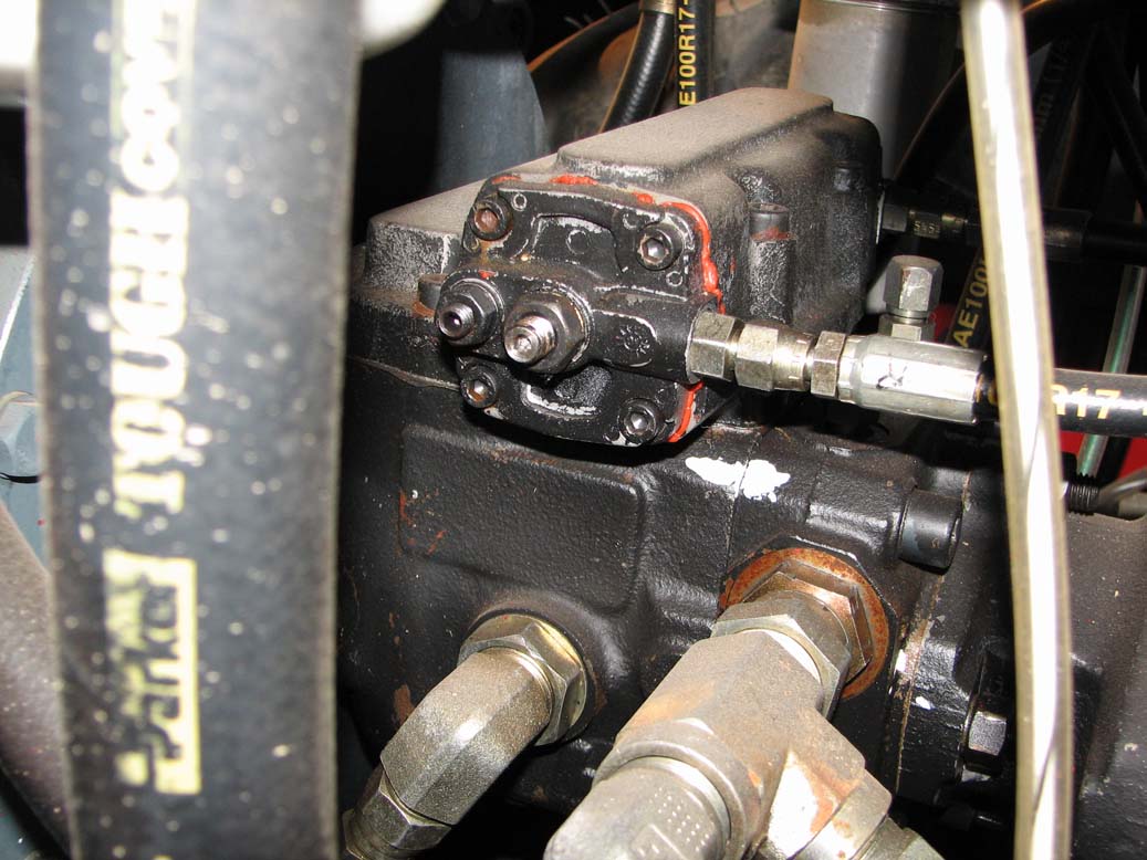

Here is some pump pix that JJ requested. Maybe Ken can post some pix of the pumps mounted, my flash is out and it is way too dark in there to get a decent picture.

Just from your first picture, there are two pumps piggybacked together, One of them is your steering and lift pump, and the other one is your PTO pump.

One more abservations as to which one is the PTO pump. Larger fittings is one clue, and the first pump looks thicker.

Picture # 4 is a very good picture of the two pumps. The first pump after the tram pump is the PTO pump, and the third pump is the steering and lift pump. Which hydraulic circuit is the high pressure filter located?

High pressure is difficult to tell, but I think it is from the lift pump
Going from furthest to closest to the engine
Lift and steering (I think) circuit - winds its way around to the PTO Activator (RPS Valve is its pro name). Then out of the RPS into the high pressure filter then to the accumulator / charger.
Second pump back is PTO. Runs out of Pump to RPS Valve. There is a disconnect for me... I see two outputs one back to the tank and one to the PTO. There is a release valve that if the PTO is activated and nothing is hooked up it dumps back to the tank. Not sure what happens when it is not "activated"
The third pump looks to be a closed loop of sorts. Operates the tram.
Now here is a mystery question. If the only oil getting back to the tank is off the case drains, then how in the heck is any of the oil getting filtered. On the 1850 it is out from tank to low pressure filter and then to the bottom of the Tram pump. The only additional hose is on the left side and it is the pressure for the treddle.

Carl, let me see if I can answer your question about what is filtered. There is a collection point on one of the manifold blocks, that collects any oil from the case drains of the wheel motors. This manifold also collects oil from the tram pump case drain, This total amount of oil is then sent to the cooler and back to tank. So what is filtered. The purpose of the charge pump is to keep up pressure , about 300 to 600psi on the low pressure side of the pump. Since the tram pump is a closed system, the charge pump will provide any makeup oil lost through the wheel motors, and the tram pump. I believe that we are only filtering about 3 to 5 gpm. Since you have a 20 gal tank, you could filter about 240 gal per hour. Charge pumps are designed to pump about 10 percent of the tram pump volume. The lift and steering oil and the PTO oil is used and sent back to tank. All or most of the oil in the tank will eventually get filtered.
You mentioned that the high pressure filter was before the brake accumulator. The only purpose I can see why it is located there, is to prevent any crud from getting into the brake system. Any filtering is good, but could get expensive. If I had to build and maintain a hyd system, I would have filters in each system, which would further isolate crud from contaminating other parts of the system. Separate tanks would be even better, but that would take up more space and make the system to expensive.
I still think that your tram pump has a case drain. That would be the only way to cool the oil from the tram pump. also, the oil coming from the wheel motor case drain is caring heat away from the motors.
Another condition that causes heat builds up is when the relief valves are going off, and when you are using the bypass valve to tow the PT, heat will build up rather quickly.
