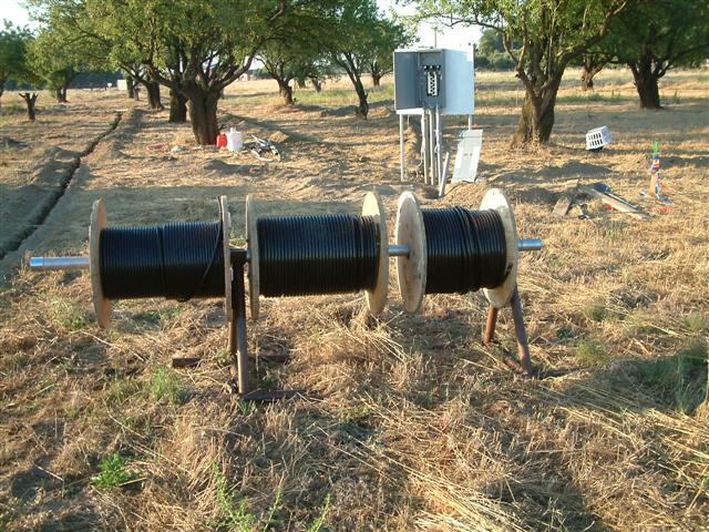

This post started a while back but I wanted my 2 cents worth in there.
like others said, it is easier to pull the length of wire through a stationary conduit than to try and pull one little bit of conduit all way down and risk getting glue all over the wires when assembling the conduit. wires actually pull pretty easy if done right. especially the thhn/thwn/USE types of wires. mtw is harder and is not really meant for service anyway. "U.S.E." (underground service entrance) can be direct burial wire & type THHW/THHN are meant for in conduit for this type of application the THHW/THHN have an outside jacket of slippery material (Teflon/Nylon like coating) which helps it pull much easier. the type U.S.E. also has the coating but a little thicker jacket meant for direct burying.
Pulling lube ONLY in any type of conduit, ya lots of stuff can be used but type #77 or T & B also has some which is only slightly more cost than dish soap and is 100% non-effecting the wire jacket.
it is best to assemble the conduit into the flat bottom trench count up the # of sticks you have and add a few feet, remember they are 10' lengths, if ya cut one in half count it as a hole length. a few extra feet of wire is cheap compared to pulling the short length out and replacing it. not to mention you can take it to the scrap yard and get back some $ for the copper scrap.
ONLY use straight runs and sweeps at ends coming in and out, if you have to have bends in there some place be sure to take a running count of the total # of degrees of bends, never have more than 360 degrees of bends in any single run a pull box is required at or before 360 degrees of turns. there are also max distances of run prior to needing a pull box. I like to ave more boxes just in case, but at least every hundred feet unless you are making one single run from building to building or to a pole. then you can stretch that distance out but beware local codes & elec companies may want pull boxes more or less at shorter distances. make sure to check this out prior to buying anything.!
Shop vac and or compressed air with kite string and a plastic bag/mouse works well for getting string started through the conduit then pull in a rope and use the rope to pull in the wires. keep a few extra feet on each end which can be cut off easily adding it back is a lot harder ;) having the conduit stationary in the ground makes pulling a LOT easier than attempting to pull wires into it then bury it as the conduit will move about a lot... something that makes it darn near impossible to do a long run with and assembling it in the trench can get a lot of dirt into conduit and glue onto wires ... adding an extra 3 wire set of 12 gauge for lights on/off is also a great idea!

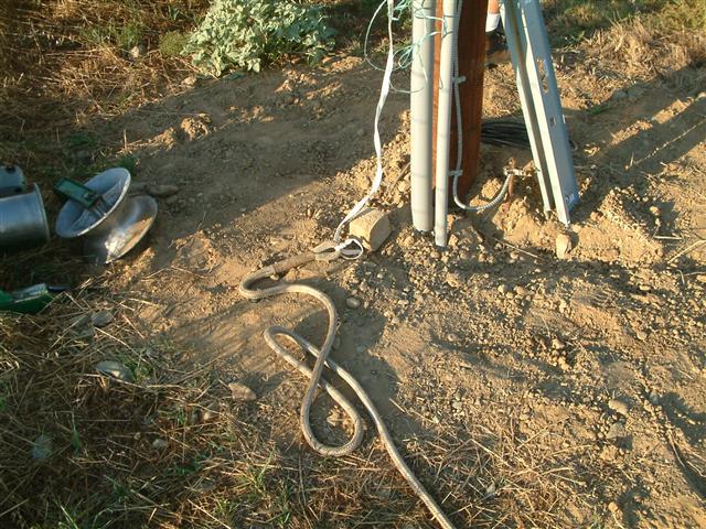

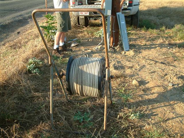

I did a 650' pull with 3-#4's and 1-#6 wire a couple of years ago and got lots of good tips here. One piece of advice that stuck - do NOT use liquid soap for the pull; only use wire lube. Something about the soap possibly doing damage to the wire over the years. I buried the conduit first, but what Eddie said makes sense for 125 ft.

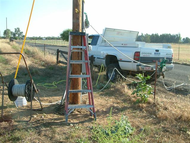

when I pull wire usually 4/0 phases 2/0 nuetral I always put a ladder above the pipe I'm pulling from and hang a pulley,dolly, wheel or whatever you may call it and put rope thru dolly and pulldown. Sometimes making a loop in rope (twisst it a couple of times and hold knot with hand) and stand on loop, comes thru nice without braking your back or cutting rope on side of pipe, as long AS PULLEY IS RIGHT ABOVE PIPE.

Back in the day, I use to pull 500 MCM all the time. We used lots of lube, pulleys, aircraft cable, and a forktruck, piece of cake.

(1) Fish tape is easier than using rope.
(2) DO NOT use grease.
(3) DO lubricate the cables; having helper to assist feeding and lubricating [with approved cable/conduit lubricant ONLY] will make job easier.
