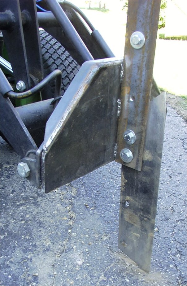

I've always wanted water out at my garden, rather than running a garden hose all summer. So I used my $10.00 soil slicer/trencher thingy today and pulled in about 150' of black plastic pipe from the house to the garden. First, I ran the blade from the garden to the house. I was able to do it in one pass at full depth, as we have pretty sandy soil, and it rained a lot over the past few days.
Next, I dug a 12" hole at the garden end about a foot and a half deep. I then laid out the plastic pipe behind the PT and under it. I folded the pipe over about 6" and tied a stout rope to it and taped it flat. Then I tied the rope through the bottom hole of the blade and lowered the blade into the hole. Then it was off you go. I just re-traced my pre-sliced trench. That is the beauty of things in the front! :) Surprisingly, it slipped that pipe right along and I was done in about 2 minutes. :thumbsup:Unbelievably easy. :) The run was mostly straight, except I had to make a left and a right around a tree. I felt the rope snap right at the end. I should have used a chain or steel cable. I figured there was tons of pressure on it. My neighbor was watching and came over. He saw the broken rope and thought it was a lot of pull too. However, I found the end in the dirt, pulled it up with my hand and even with the pipe a foot under ground and an S curve in the middle I was able to pull the pipe back and forth through the entire trench with just two fingers. I really cannot say why the rope broke at all. A child could have pulled it. Perhaps it caught a tree root or something.
Anyhow, all that blade is is a plow share I found at TSC about 8 years ago for $10.00. It works great and I highly recommend it if anyone wants to pull water lines around their yard. It left very little damage that will probably be unnoticeable in just a few weeks. :thumbsup:

Yes, I pushed. On my PT425 I can see the grass between the front of the tractor and the quick attach plate. I was able to put the bottom of the QA just a half inch or so from the ground and keep it there with constant adjustment of the joystick. I strayed from the original slice by no more than 1" here and there, but I'll bet I stayed in it 90% of the way.
As for pulling electric, I think there is some minimum depth required and I don't think this unit would go that deep. But for low voltage wiring, telephone, cable T.V. and water lines for sprinklers, I think it is fine. Just check local code first. ;)

I imagine it would work in either direction. I have that small area behind the house that is still fenced in. I did not want to take down the fence for the last 10' of run. So I used the slicer to pull a slice away from the house, then turned around and pushed the slice to the fence. I then used a flat bladed shovel and spread the slice open and dropped the water line in by hand. The only place I had to step on the shovel was where I ran the opened slice over with the tractor tires, which effectively closed it back up. :laughing: It helps that we have very sandy soil and had a ton of rain last week, too. ;) I pulled 1/2" I.D. pipe, which is a tad over 3/4" O.D.

I also considered using a larger sweeping bent pipe to bury the water line. I would have turned the blade around and mounted the curved pipe behind the blade and fed the water pipe through it, then pulled the trench. You would need some sort of spool or perhaps a 2nd person to help feed the flex pipe into unit, but it would get buried as you went along. I have seen several people here on TBN do that for wires and flex pipe. However, I did not have a large enough sweeping pipe and wanted to try this first. Nothing to lose but my time. Also, I was worried that the PT would have problems with the drag that a larger pipe would put on the unit. With the sandy soil, I now figure that probably would not have been a problem.
Again, I was completely amazed at how easily it pulled in. If I ever do it again, I will use a small section of chain or steel cable instead of the cheap poly rope that I used. That would be the only difference.
Give it a test try in your soil type and see how it goes, if you are interested. If you have a really nice lawn, make sure the blade is very sharp so it doesn't bunch up the sod instead of cutting it. ;)
