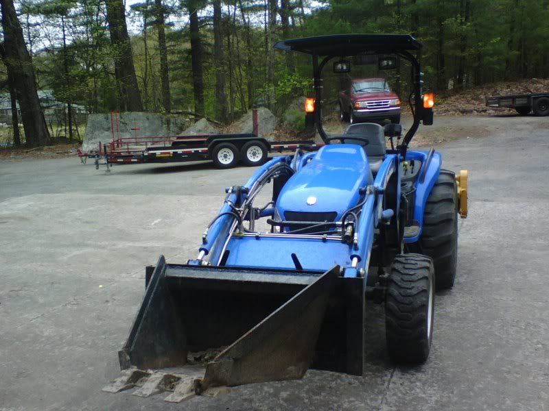

Here's what I use on shrubs,trees,stumps (within reason) so far I haven't had one make me say uncle.Another plus is that it can be used to transplant shrubs reasonably well.I got it used for short money,the guy said he bought it out of North Carolina,I'll say this about it,you would need a **** of a big tractor to damage it.

Hey Brian, Does that bucket give you any trouble when pushing it into the ground? I have been trying to get some real world facts about how well they work on a tractor rather than a skid steer. Some of the dealers I have talked to have never seen them used with a tractor and are hesitant about how well they would work with something lighter than 6000lbs. Any limitations or issues using your on your TC40DA?

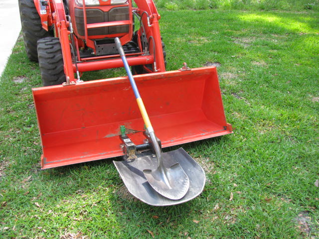

I'm looking for some clever ideas: how do you guys best pull unwanted shrubs and/or small trees? I've tried the tractor and chain and the chain never fails to slip off and over the darn things, no matter how tight I get it ...

A lot of the guys use a grubber, Northern Tool among others sell them..I made something of my own that works well for small shrubs.. take a piece of pipe 1 inch or square 1 inch tubing, about 6 inches long. Weld a length of (about 18 inches) small chain, I think I used one rated for about 330 lbs on to one end of the pipe on the outside. weld a long 1/4 inch bolt or long nail to the other end of the chain, to function as a "needle" to thread thru the pipe or tubing. I also made an adaptor (chain hook) to hook on to the small chain, with a piece of 5/16 chain on it to slip in my regular chain hooks on my bucket..Yes I know one picture would be worth about 2000 of these words, but it is raining, and I don't want to go out and photo it. Anyway the small chain when wrapped around the bush, and threaded back through the center of the pipe, will push the sharp edges of the pipe or tubing up against it and it will not slip.. It will pull up your bush with the hooks you have on your FEL bucket. This works well, is not a lot more trouble than the grubber to hook on, and cost's next to nothing to make.

Hi John,I haven't really had any trouble at all getting it into the ground sometimes you have to rock it back and forth a bit.The teeth make all the difference in the world.
