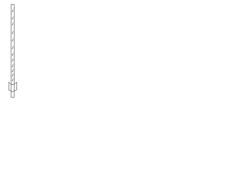

What I refer to t-posts is the metal post for wire mesh fencing. The t part actually looks like a triangle up around 4-5 inches from the bottom of the post. The wire mesh hooks onto the post because the post has many J type metal hooks on the side. Rough diagram attached.

Hey, thanks guys. Now that you describe them and I've seen the picture, I realize I've seen them, just never had the opportunity to be around them. Now, at least, I won't feel lacking next time someone mentions them. You know what they say, "the only stupid question....."
