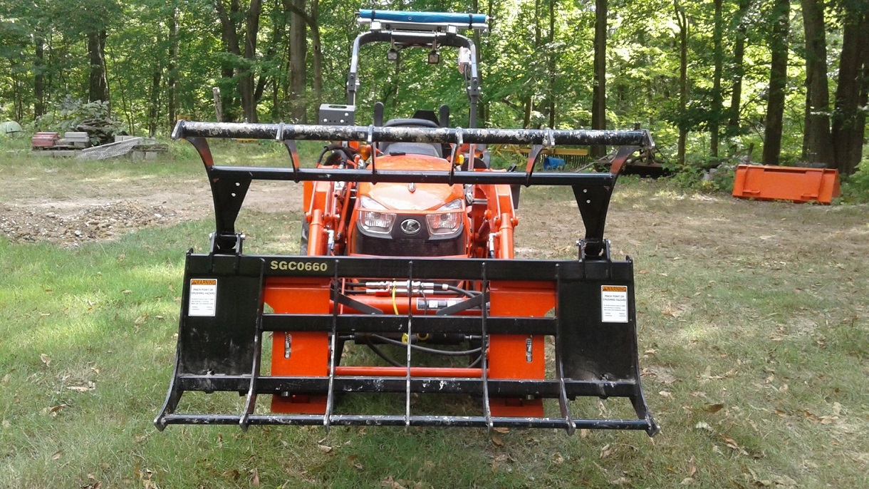

Mowing is the fastest option for small saplings. Or spray with vegetation killer now and mow in the fall. A root grapple can be be used to pull 1"-2" stuff. may get too much dirt in your burn pile. A tree puller is amazing and fun implement to use. My B2650 maxes out in the 3"-4" range depending on tree species and soil conditions. Larger trees, chainsaw - grapple makes debris cleanup easy.
