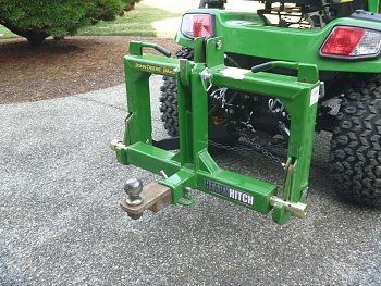

Toppling the tractor is possible with both methods the O/P mentioned. If you are going to pull something of unknown resistance, you need to use the drawbar, so that the tires will spin instead of toppling the tractor on top of the operator!
David from jax
You are correct sandman... and that's what I meant by pulling. Thanks for clarifying. :thumbsup:
   / Pulling bushes via FEL or 3 point? #12
Make one of these for the three point. Lift or pull but keep lots of weight in the bucket as backflip is possible if not done properly. It will give terrific traction.
Another alternative is to bolt a couple of pieces of square tubing to the bottom of the bucket that extend out about a foot. Dig in and use tilt while going forward.
