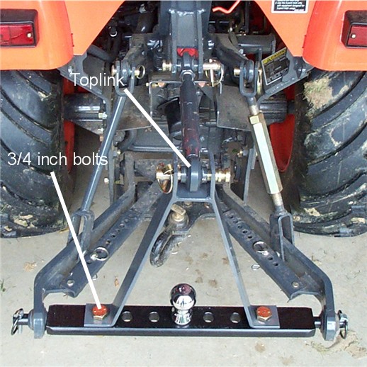

Hi, I am planning purchase of either a BX1500 or a BX2200. It is a replacement for a JD318. On my JD, I often tow a small trailer or various equipment behind it (aerator, sprayer, dethacher, etc.) I need to do the same with the BX. How do you guys accomplish this? It seems to me that the 3-point-hitch gets in the way of these attachments.

The BX has a fixed drawbar for towing attachments. You can also use a cross drawbar that fits between the arms of the 3PH. (see picture) The problem with the cross drawbar is that the 3PH on the BX does not have down pressure. You have to have moderate tongue weight for it to work properly.

Yes, the BX has a drawbar. You can see it on the picture that I posted in the above post. I keep a clevis on my fixed drawbar so that I can hook a chain to it.

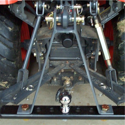

I got the cross drawbar from the dealer. I think he sells them for about $30. I worked with a metal fab shop to design and build the "A frame" to prevent the cross drawbar from rotating on the 3PH. I plan to have some made up and try to sell them on Ebay. Just haven't had time to get things started.
Attached is another picture where you can see the BX drawbar a little better (and also the cross drawbar and A frame). You can see that I have a clevis attached to my BX drawbar.

Your A-Frame is BEAUTIFULLY done! I'd love to order one. How much were you thinking of selling these for?
