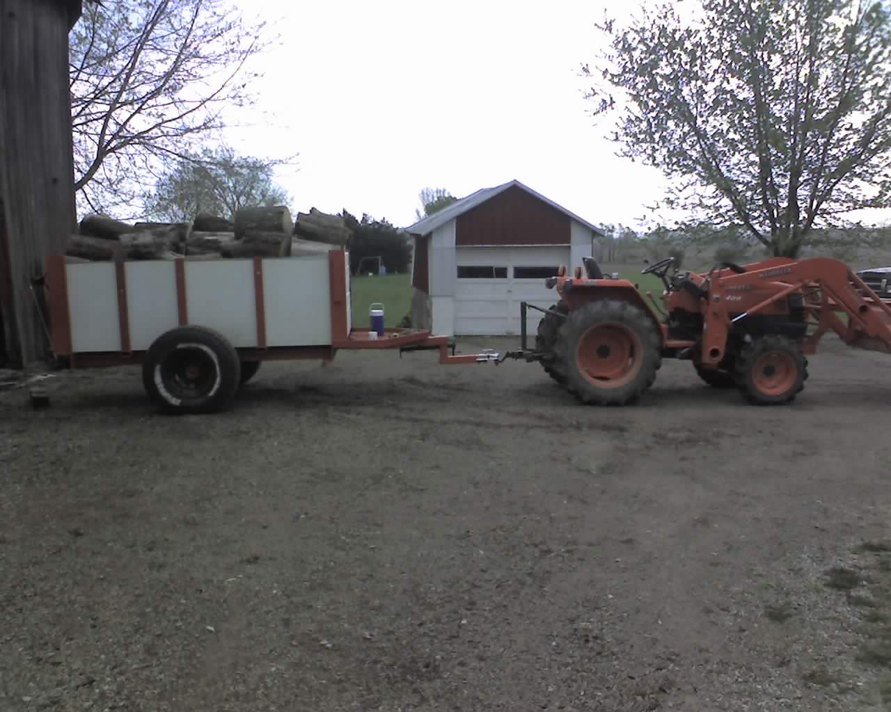

I agree that I dont see the harm in pulling from the 3PH.
Everyone keeps talking like a 3PH is made of flimsy little peices of steel behind the tractor. Infact, my 3PH for a smaller tractor is...quite beefy:thumbsup:
There is no harm pulling from the 3PH, as long as you take a few considerations into mind...
As others have mentioned, gravity is the only thing that holds it down. So...this will rule out a dump trailer, or poorly distributed loads. As well as consider the 3PH raising when emergency stopping, on hilly terrain.
If none of those apply, no big deal to use the 3PH. If the issues above apply, you can either chain it down to prevent rise (which will rule out quick hooks/unhooks), or use the drawbar.
But if your tractor is anything like mine, or most that I have seen, the drawbar is set up WAY too low for most commercial trailers that are designed to be pulled with a truck.
That, PLUS the easy hook/unkook is why I like pulling with a 3PH hitch.
Your tractor is heavier and physically bigger than my L3400. But we regularly pull loads like this from where we cut wood at ~3miles away. No issues at all. And thats about 6k lbs too.
