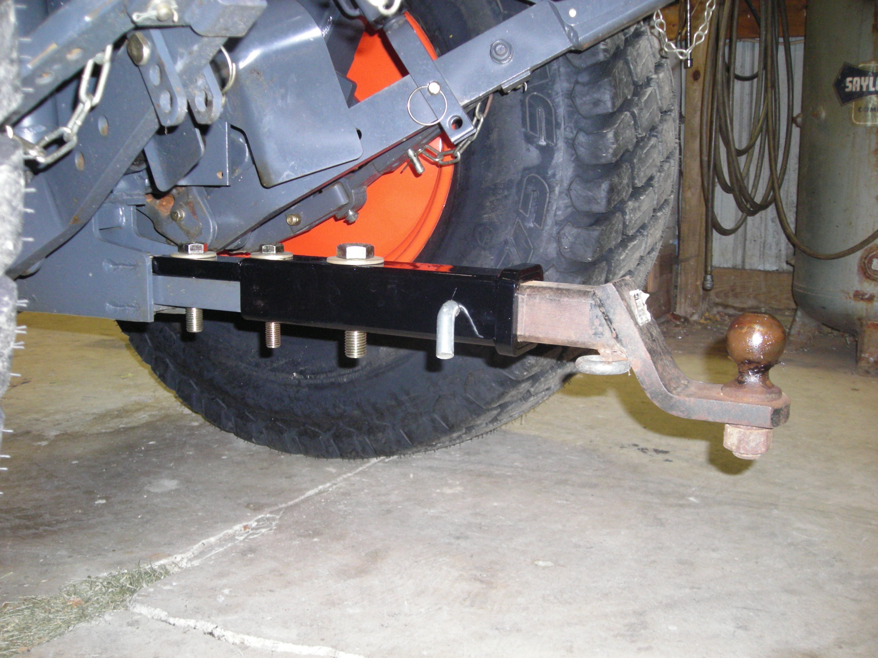

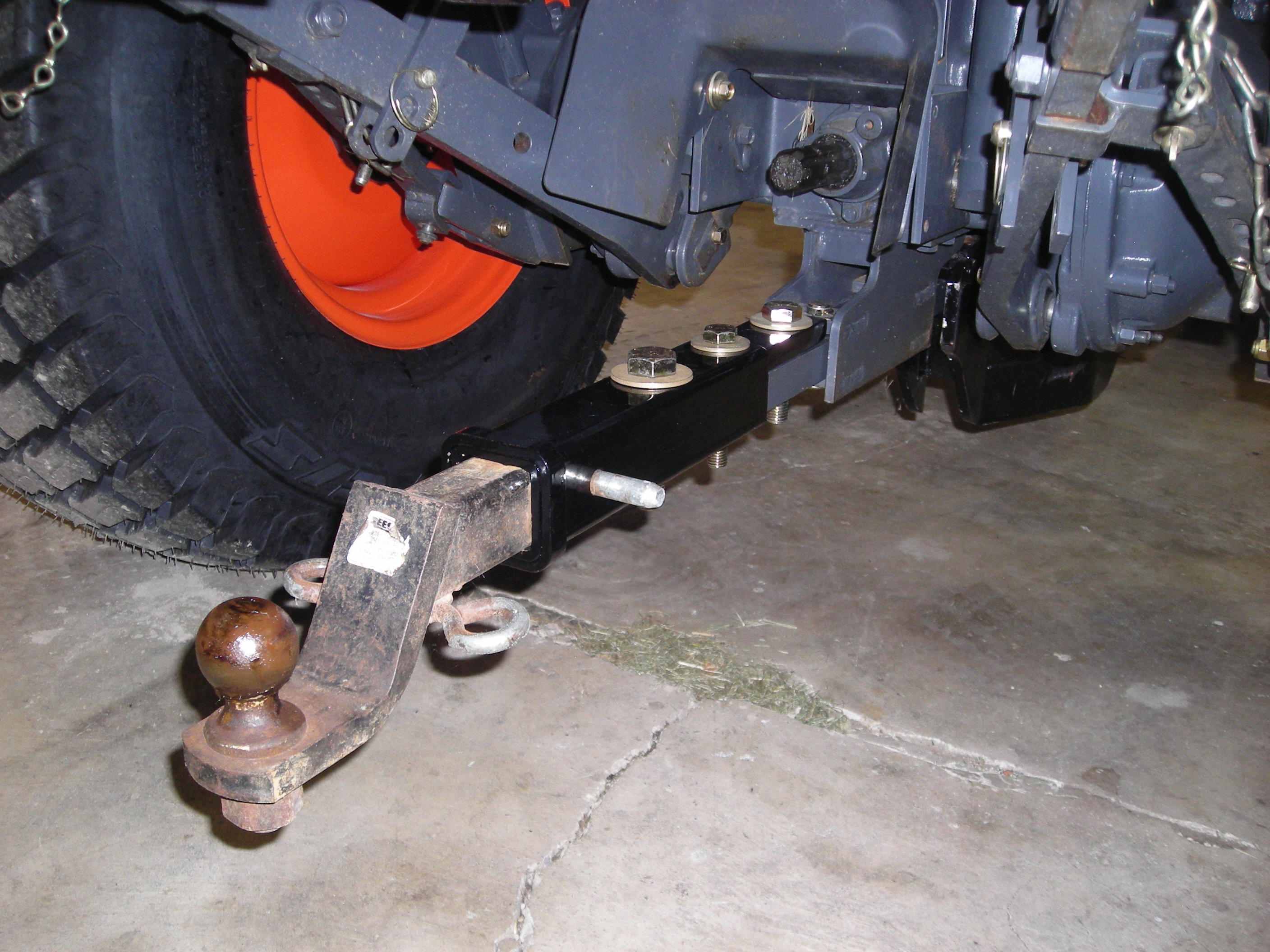

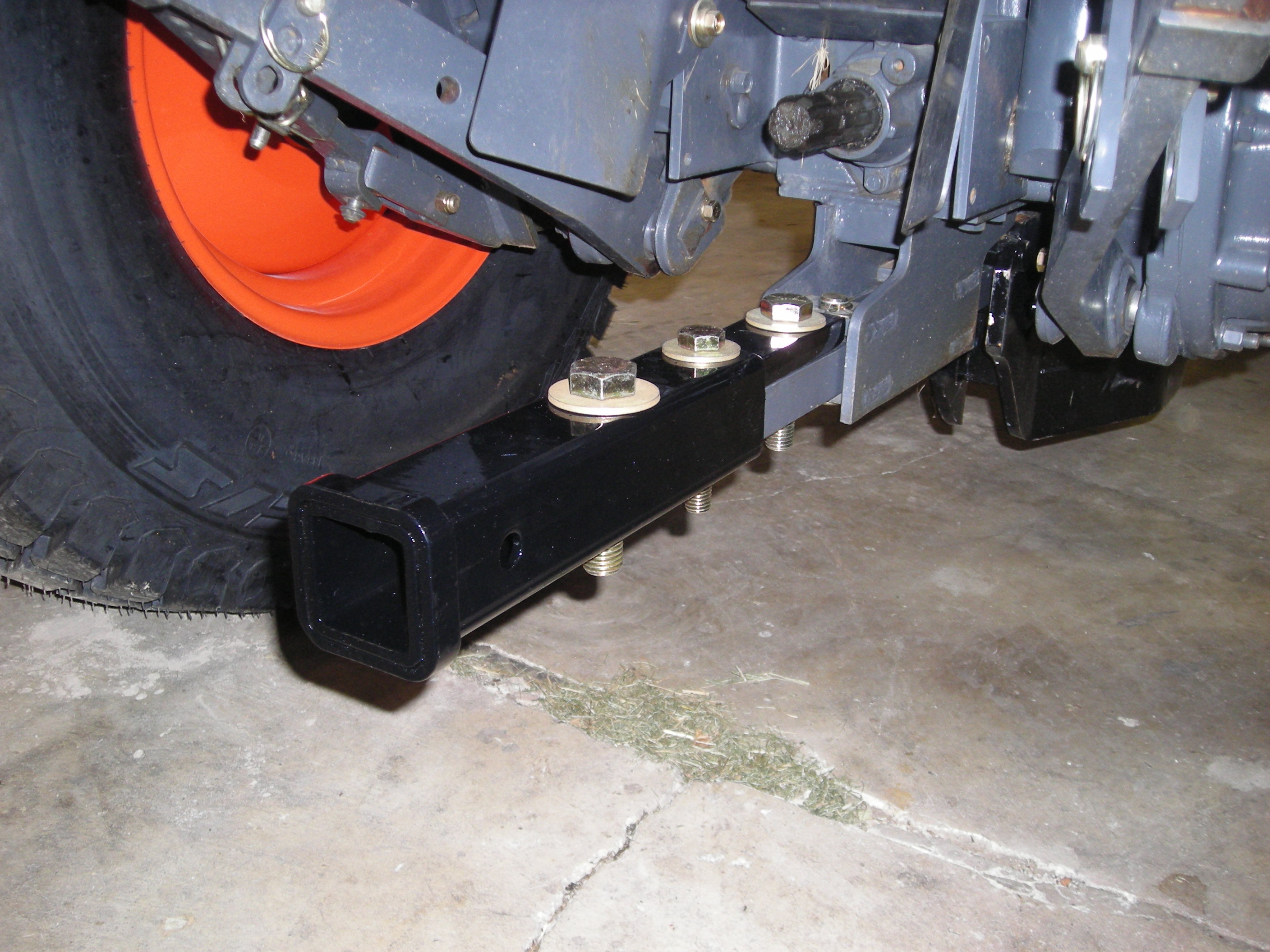

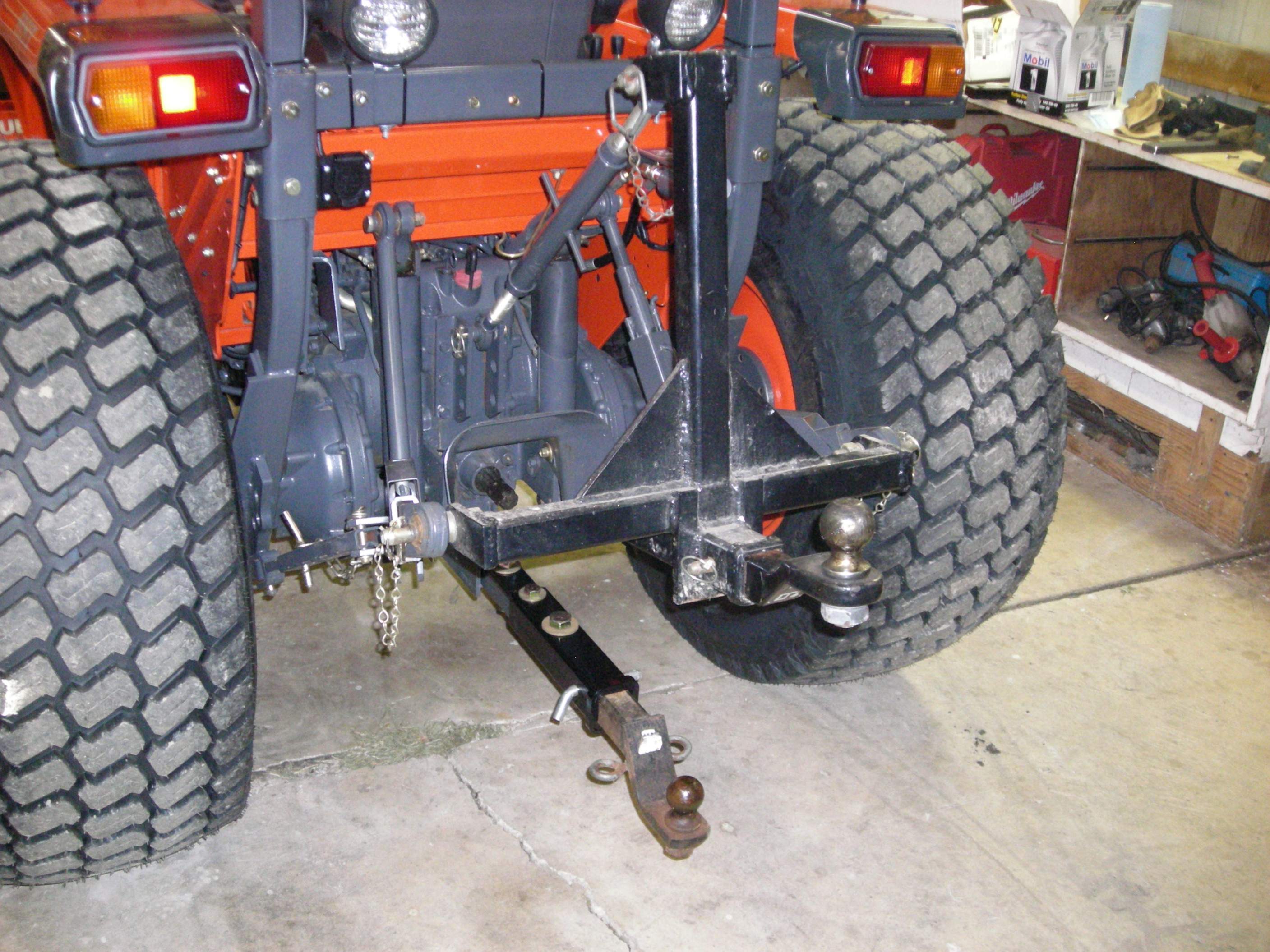

I try not to use 3 point as others has mentioned, if tongue weight goes negative, arms come up. But, I do use my 3 point for moving things around when I know I have plenty of tongue weight because it is easy. Here is a drawbar 2" receiver adapter I made for pulling a trailer with passengers. Yes, I know there are no nuts on the bolts, did not have them on yet. Philip.

Philip,
Did you make the receiver stick out that far to get behind the tires or is that just the way things worked out?
/ Pulling a trailer with your tractor #10
Philip,
Just the way it worked out. I got receiver from TSC. I got flat bar from McMaster Carr to weld in receiver. Both pieces bolt to tractor drawbar. By the time this was all put together and 2" ball drawbar was installed, this is where it sits. Philip.
