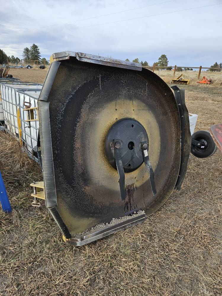

I've got a LandPride 1860 rotary cutter with a leaky output shaft seal, possibly other gearbox issues. I got the castle nut off the bottom, but am not able to get the stump jumper off the gearbox. Crowbars, 7' tamping bar, propane torch heating up the outside of the splines, no luck. I can't get a great place to pry as the deck & pan on the stump jumper flex a lot. But I heated things up & was prying as best I could. Beat on theings with a hammer & some rebar as a drift. Flipped it right side up & pounded on the top of the stump jumper througth the big hole for accessing the bolts holding the blades to the stump jumper.
Any suggestions? Get a better torch than my little yellow bottle MAPP gas torch? Porta power that may get under the stump jumper to try & pry closer to the center of the stump jumper?

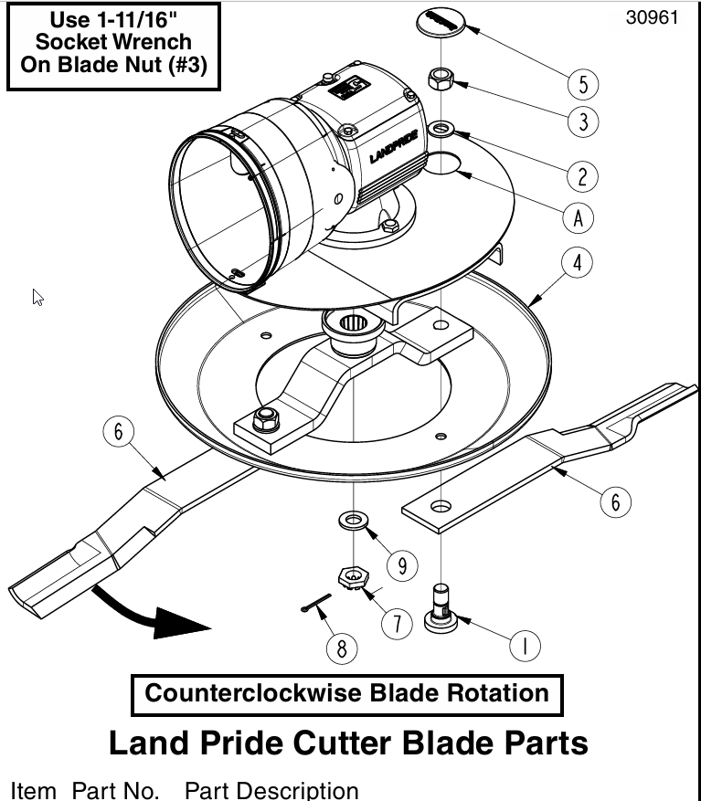

There's most likely a splined/keyed bar behind the disk and blades. Pull the blades off first then the disk should come off. The bar may need a puller to get off.
   / Pulling a stump jumper off a Land Pride rotary cutter? #6
That sounds like the proper way to go, easier than a hydraulic spreader. A 2 jaw puller would make short work of it. I took this diagram off the Land Pride website. I used my Land Pride model number to look up the manual.

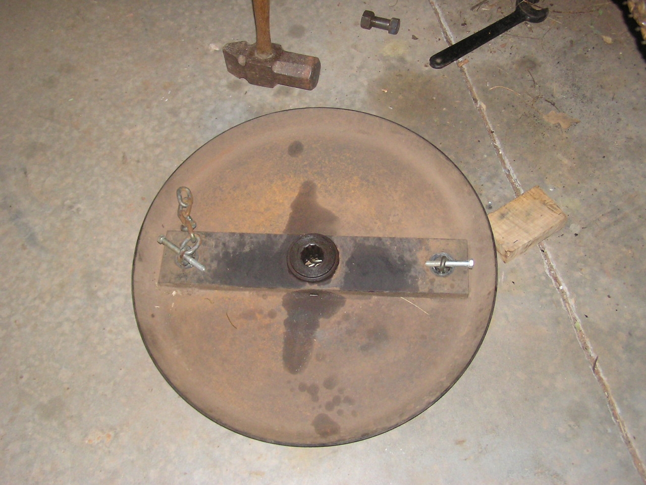

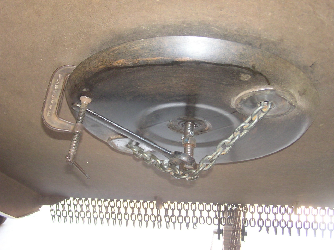

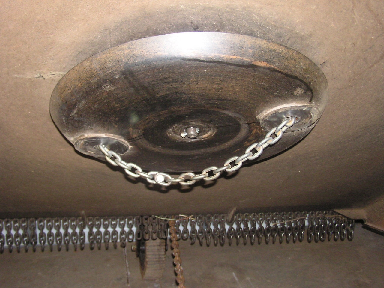

This is what I did to remove the stump jumper on mine:
Put another wrench on the head of the big bolt and did "lefty loosely" forcing the nut down putting tension on the chain.
The little bolt through the shaft, kept it from falling when it broke loose
