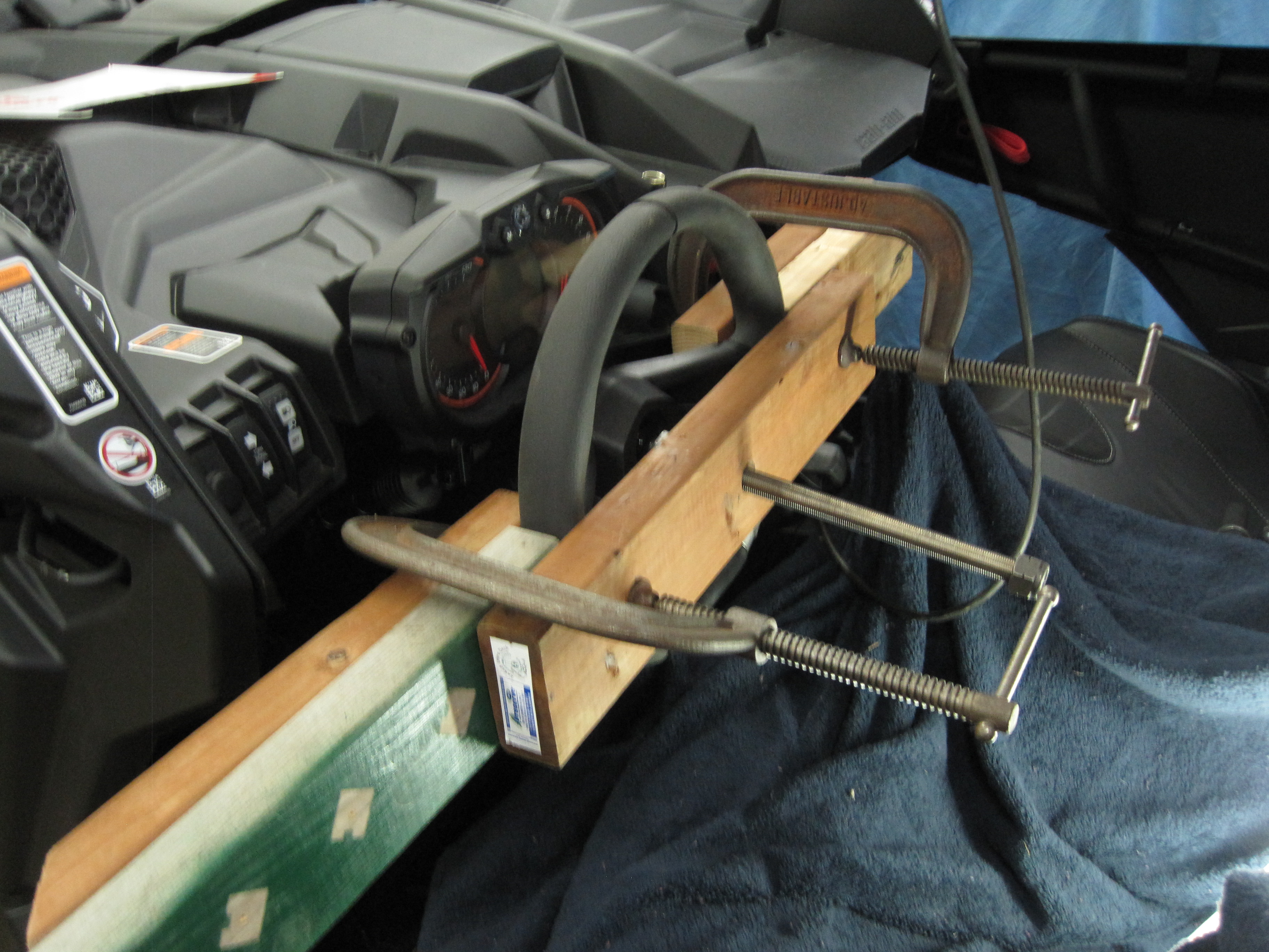

   / Pulling a steering wheel #6
I needed to remove the wheel from a project side by side that didn't have any puller accommodations. I used some 2 x 4s, c-clamps and all thread. The all thread has a nut and washer behind the 2 x 4 that is not visible (jpg attached I hope). Clamped it all up and then loaded up some tension (cautiously) on the rod nut, a couple whacks on the rod with a hammer then more tension. Repeat as needed until the taper released. It helps that the tension is constantly applied, yours may need some penetrating oil as previously suggested. IMG_6288.JPGIMG_6288.JPG
