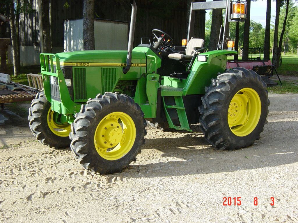

Am I dreaming? Would my JD 6200, with about 70 PTO HP pull this thing? Sounds dumb, but I should have measured it.
Thanks for the input.

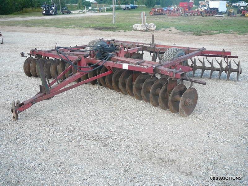

Should be easy. Looks about the size we used to pull with 45 hp tractors.
/ Pull Type Disk, Would My Tractor Pull it?. #7
Unless you add a lot of weight to your tractor, I don’t think you will pull it at more than 1-2” deep.

Nice looking Deere.. The disc is probably to big..

I have about the same size Kubota. Loaded tires, 4WD. I pull a offset disc, narrower than that one but every bit as heavy. But an offset is more aggressive, ie bites more. Even though I set it at the least aggressive angle, it still taxes my tractor, especially in damp soil or uphill. That being said, it cuts like a beast and I use it a lot. I can always raise it a little to reduce the drag.
The disc you show is wider, but probably not much heavier, and by nature is less aggressive. I would call it a smoothing harrow, rather than a primary tillage tool like an offset or plow. But if you set it less aggressive, and not use it when it’s really wet, I bet you can use it adequately. And you can always lift it a little if you start to bog down.IMG_0618.JPG

I think you can pull it with no problems. I borrowed a 14' and pulled it with my Kubota L5740 (about 57 hp) and pulled it fairly easily. I had to travel only about 10 miles to the job site, so pulling it behind the tractor down the road was not too bad.

Is the disc spacing around 6 inches or nine inches? I count ten blades per gange so 60 inches or 90 inches. Guessing 6 inch so around 11-12 ft
Depending on soil type I suspect you should be able to pull this.
We pulled a 10 footer with 2WD 5600 Ford to level alfalfa sod after being moldboard plowed
