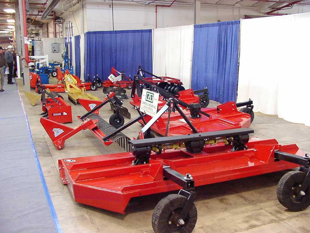

More Kodiak implements... pictures taken @ New York Farm Show 2003...
Hi Slippy,
The cutter finish is average, however I'm not that impressed with the A-frame for the 3-pt hook-up... not heavy duty enough for the abuse it will take over time... it needs to be beefed up and reinforced... but many implement companies are this way... not just Kodiak...
Before I'd consider parting with ~~$4K plus for a 10' Kodiak pull rotary cutter... I'd check out some local auctions this summer and look at some HD Rhinos, Bush Hogs, Browns, etc.
Let someone else take the hit on depreciation and you'll surely find a "useable" bargain or two... /forums/images/graemlins/smile.gif
