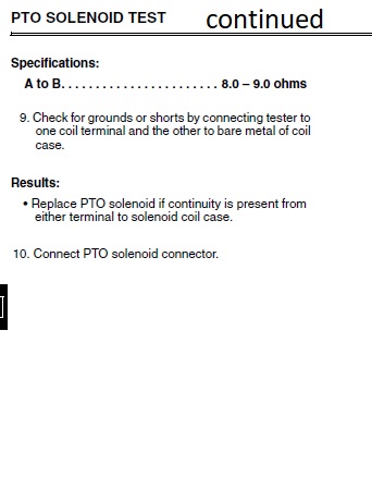

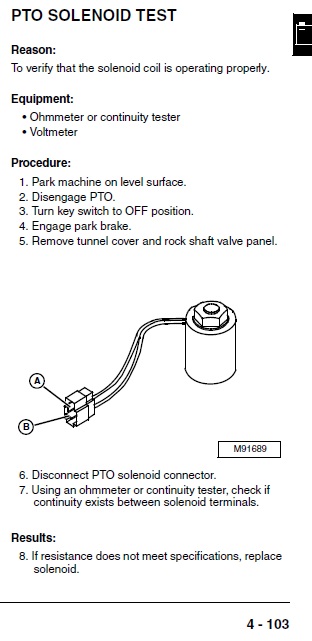

PTO will continue to turn with switch off. Not able to stop with hand pressure. Not sure if its the switch or something more serious. Any recommendations before send to a repair shop?

Here is a pic of the theory of operation.. may help you understand what may be going on.
Sounds like a check of the PTO solenoid is in order. Because I'm seeing it in the service tech manual, have added that test of the PTO solenoid (parts of two pages)

Reading the theory of operation post by beenthere (thanks) it sounds like your PTO solenoid is staying engaged. It could be still energized or stuck in the engaged position.
Unplug the PTO solenoid, then see if the PTO stops. If not, it's not the switch.
