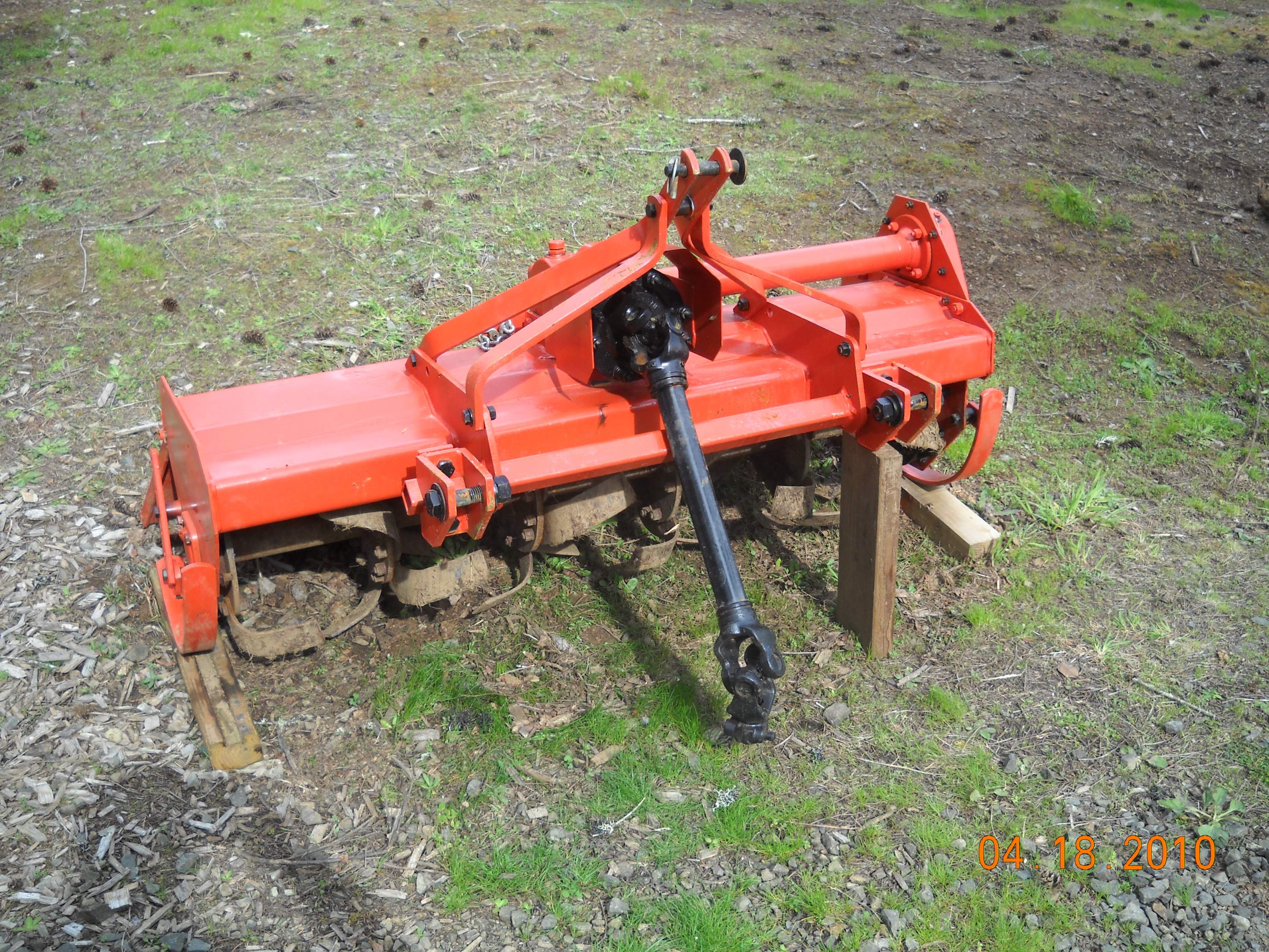

I have a KK 48'' Tiller for my BX 23 and BX1500s. like it real well.
The picture shows it on one of the BX1500s.
