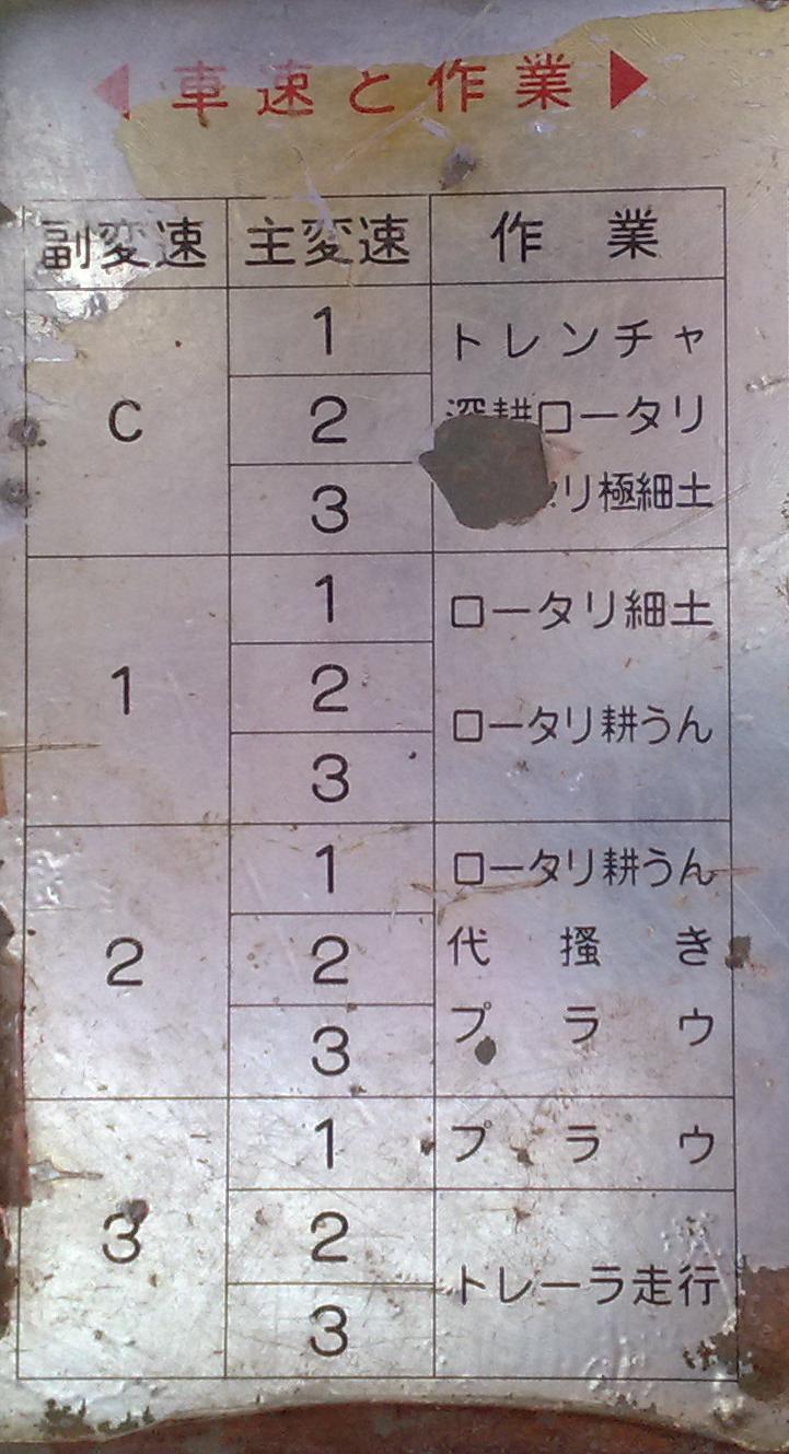

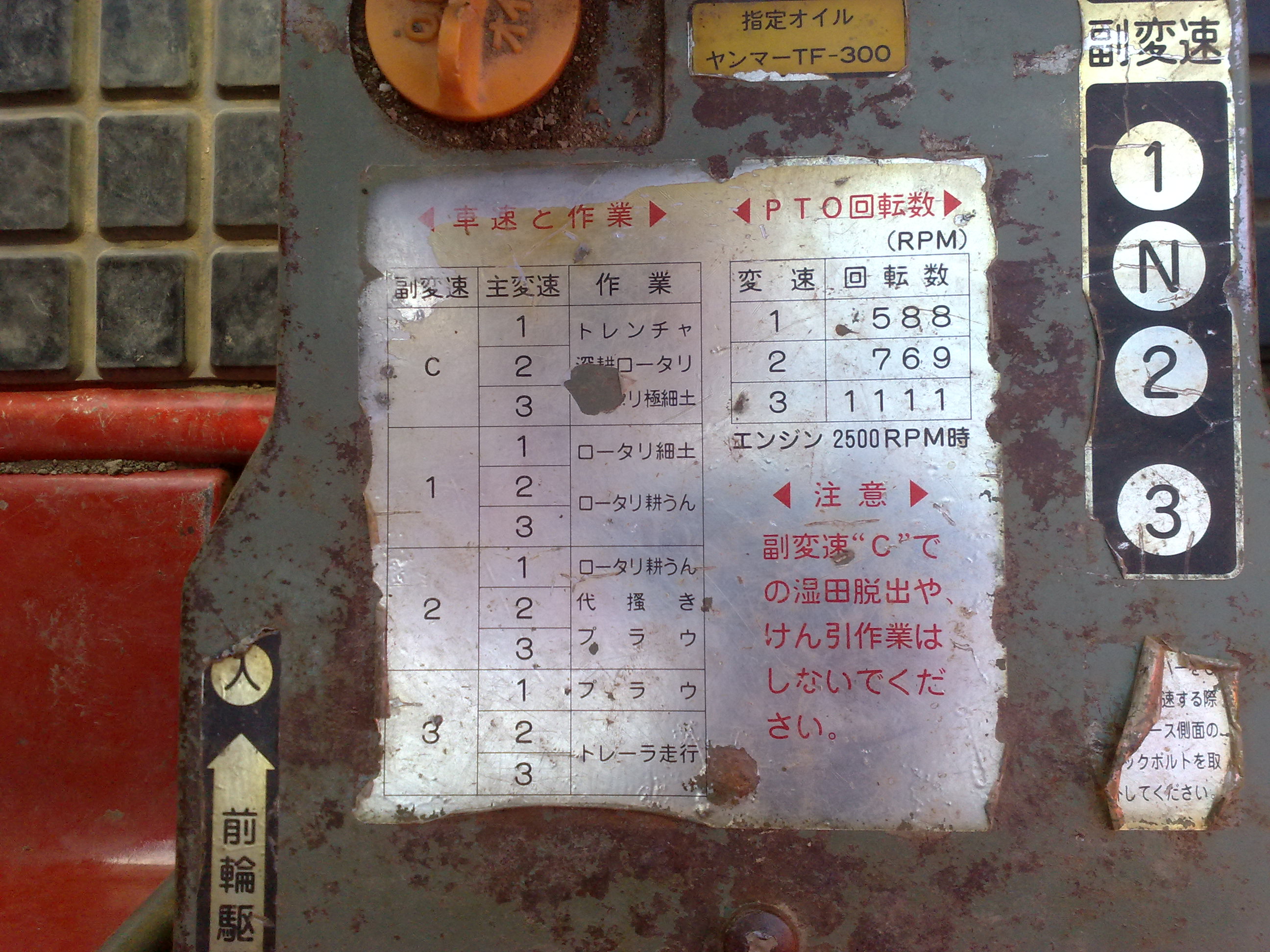

Look at the decal on my 1610 D,
but maybe there is someone who can translate the japaneese (speed? or what ever) what is written beside the gearnumbers?
Stefan

Hi Danny, the speed of the PTO was Known at the speed of 2500 RPM.
I was thinking of the japaneese singns after the "gear sheme" :confused:(left side of the pic).
Stefan
