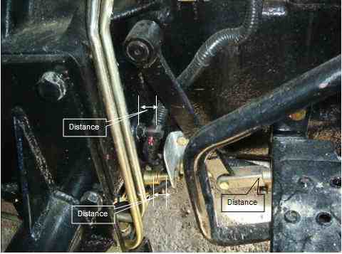

PTO problems, can anyone help, Please!! Jinma 284LE 2005 vintage, Loader, backhoe, snowblower, chipper, cultivator, plow, log splitter, generator, mower, bush cutter, scraper/grader plow.
Problem: PTO, once engaged, makes a horrible noise (high shrill) and when I press the clutch all the way, it is still engaged. When I disengage PTO, the noise is gone and the PTO is stopped. The speed control for the PTO is in neutral during this excercise.
Worked like a charm for two years clearing snow, I have 62 hours on the tractor.
I have adjusted my clutch, 2.5mm for fingers to release bearing, 2mm for the PTO settings. I have increased the pedal travel by two full turns.
I have replaced all the fluids in the tractor when I first got it. I am in northern Quebec in Canada and do not have a local, nearby dealer.
Any ideas??
/ PTO Speed #18
Here are some pictures of the settings of the engage lever, the speed lever and the settings on the clutch. I also show you that a simple hanger that you choose and measure will do the trick for a guage of 2.5mm for the clutch fingers adjustment.
The high grinding noise is influenced by the clutch. When I disengage the clutch, (push it all the way in) the grinding stops, when I lift my foot just a bit, it will start up and then stop. The PTO is moving through this excercise, it never disengages unless I pull the disengage lever up.
Help!!!!

There is an inner and outer shaft thru the transmission which is how the dual clutch controls the torque to the PTO separate from the main transmission. The PTO is the inner shaft. You could possibly have a lubrication problem to this inner shaft. This has been noted by several people. I don't recall the exact fix.
You might also get more responses if you start a fresh topic in this chinese tractor forum.
/ PTO Speed #20
Thanks, I have posted a new thread called PTO problems
I will give the shaft a couple of hits with a rubber mallet and see what happens, maybe the shaft will become loose.
Do you think I can spray some grease in there with one of those spray grease cans? I suspect grease in a clutch is a no no!
