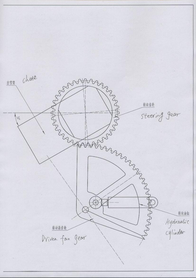

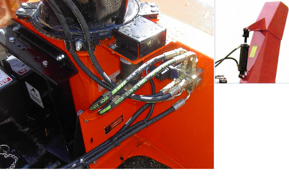

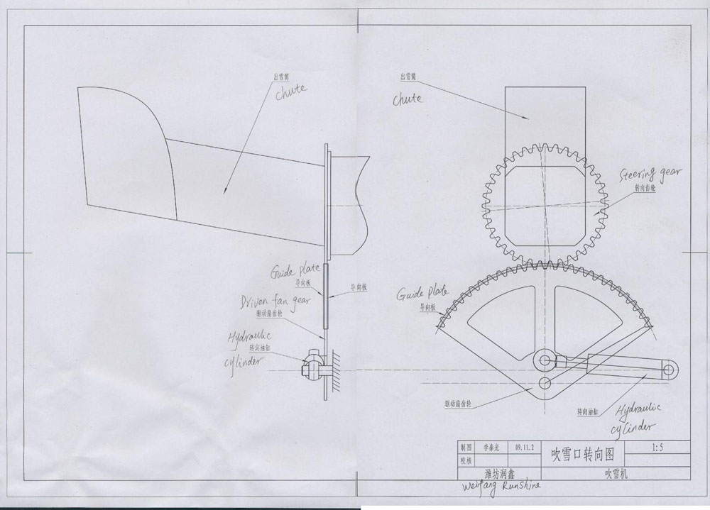

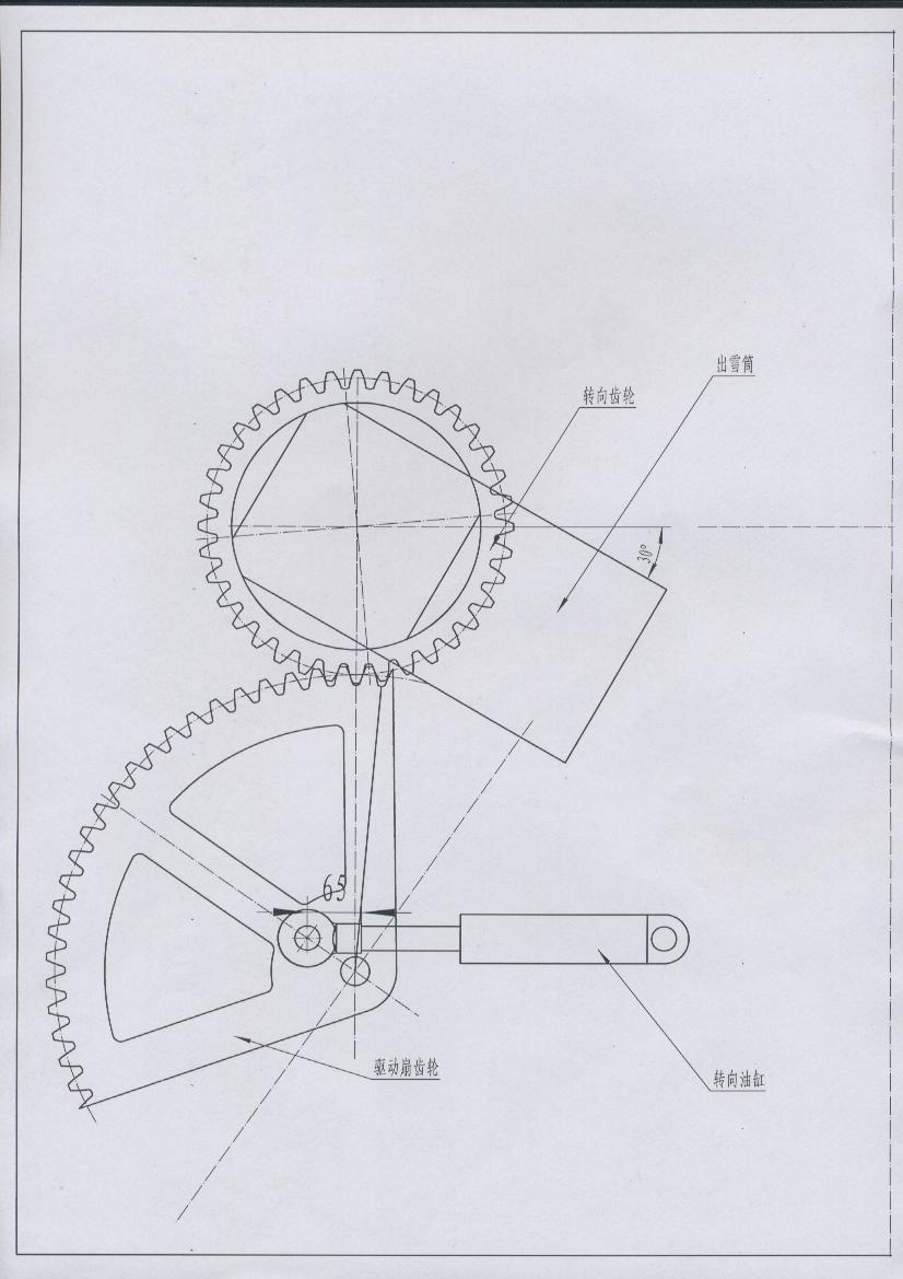

Adrian, that's a neat setup. Did you modify an existing blower or buy it like that? Tell us more :) Looks like your chute is a hand crank, any thoughts to adding an electric motor like from a windshield wiper or power windows motor?
about the chute adjustment,we now design a hydraulic motor or cylinder to rotate and adjust the chute and discharge part.:D
