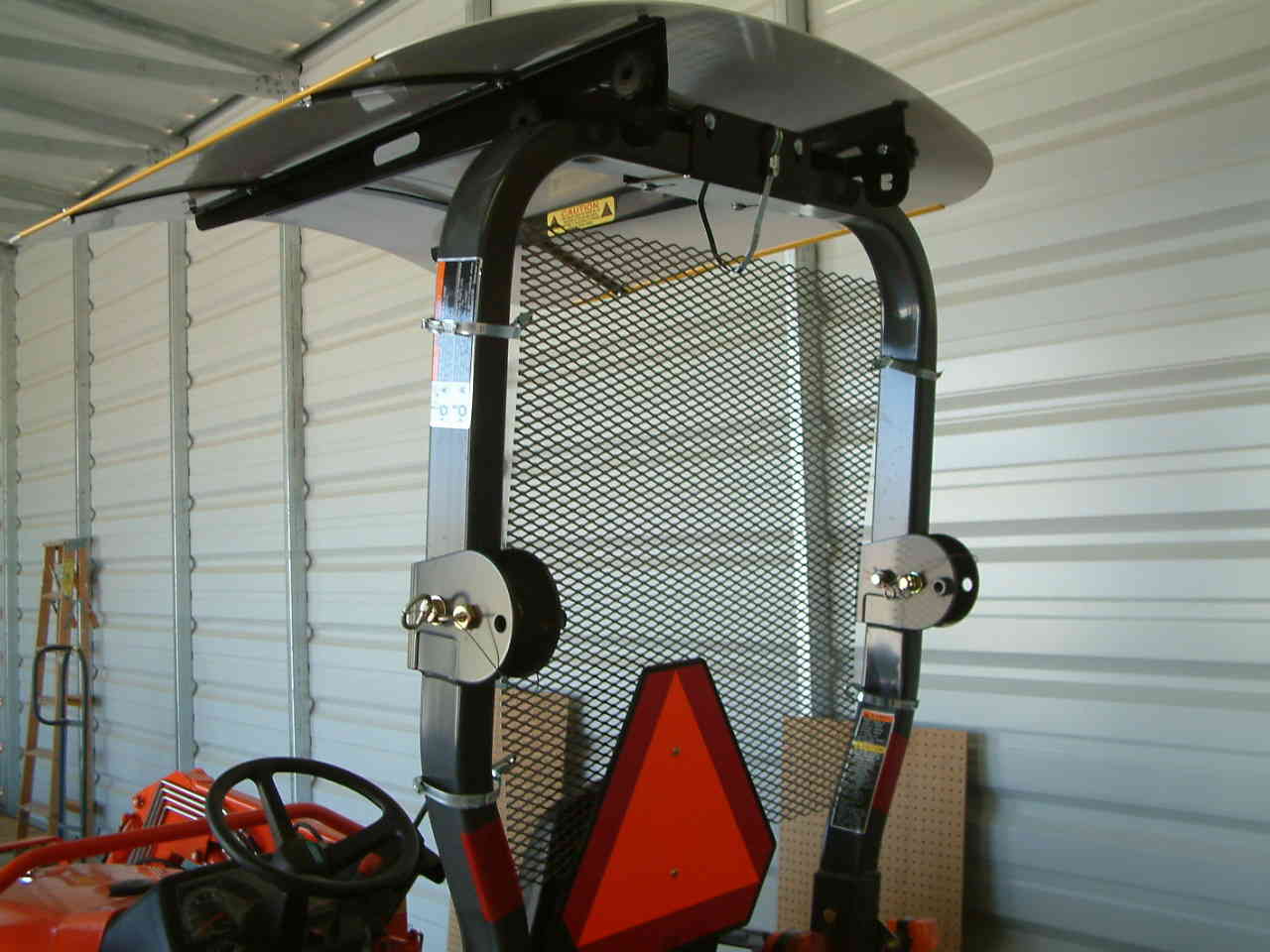

Not trying to argue with you, I am just a little confused. If a bolt happens to break or the nut came off wouldn't the spring shoot away from the clutch? If that is the case I would think you would want it pointed away from you towards the implement. If it was on the implement end it would fly towards the operator. Or is there some other danger with the springs? I have one on the tractor pto basically to protect my tractor. I have a 4010 and a 4 ft KK rotory cutter. Whenever I would kick in the pto the shock would break a roll pin in the universal joint on the driveshaft from the engine to transmission, even at idle. Now it kicks in smoothly without the jolt. I can't imagine what would happen if I hit something big with it without the clutch.
I prefer not to guess which way the (possible) shrapnel is going to fly. I just protect my backside (see attachment).
