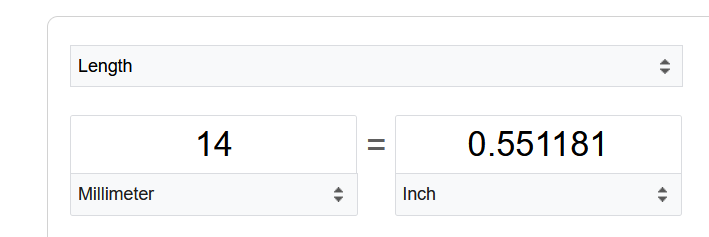

a 14mm bolt is slightly larger than 1/2" Maybe see how that fits (or doesn't)
   / PTO Shaft to Gearbox Bolts Keep Breaking! #128
13mm would be a smaller step at .512.
14mm is closer to 9/16.

Can you buy 13mm bolts? They aren't listed on the charts.
