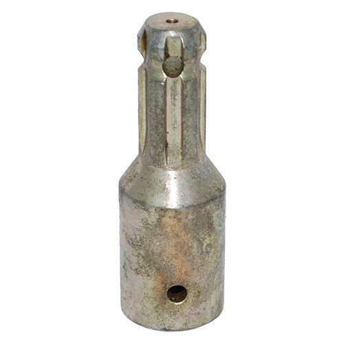

Stick something like this 112A226 1 3/8 X 6 X 12 Splined End Shaft in the Pump.
Cut to length, drill a hole, and use a PTO shaft that has 1-3/8 smooth bore (shear bolt style).
/ PTO shaft question #13
Do you have a PTO shaft to shorten?
This is a PTO Adapter, there are a lot of variations.
The best way to search for something like this, is to do an image search.:thumbsup:
Here is a tractor end:
