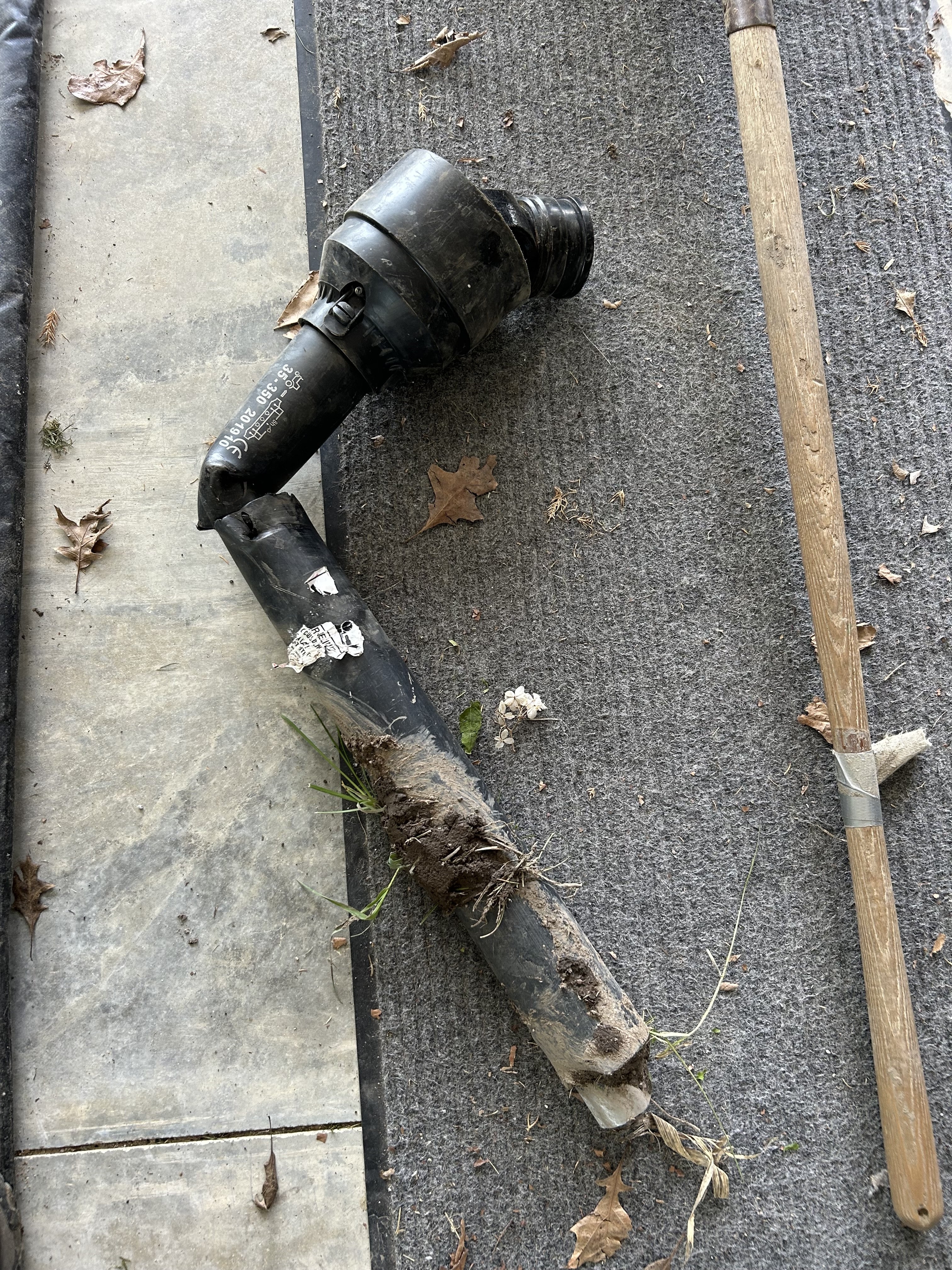

May 3, 2026 / PTO shaft Deere 3033 #1 Tpondel Gold Member Joined May 17, 2019 Messages 337 Location NW OHio Tractor Deere 3033r Bent the PTO shaft today. Don’t ask, just bring stupid. Question… can you just buy the shaft and not the whole thing? The hub looks like three screws to remove. Other half of shaft is good. Attachments IMG_4432.jpeg 8.7 MB · Views: 41

May 4, 2026 / PTO shaft Deere 3033 #2 ptsg Super Member Joined Apr 3, 2013 Messages 7,813 Location Portugal Tractor Branson F36Rn - Agria 8900D You can get just the tube for it: PTO Tubes The plastic shield/cover though, that's often gets more expensive than buying a new complete shaft. PTO Safety Shields

May 4, 2026 / PTO shaft Deere 3033 #3 Roadworthy Elite Member Joined Aug 24, 2019 Messages 4,064 Location Southeast Washington Tractor Kubota L2501 HST, Yes, you can buy the inner and outer tubes separately - done it. You'll still have to do your cutting, drilling, and mounting. If you need a new sheath that's a separate problem but perhaps you can straighten and use the original.
