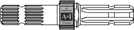

These pictures might help, the splines are different for the two speeds.
He is holding the 540 rpm end.

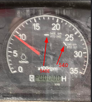

Your tractor's tachometer should have a mark on it that says PTO. That's the revs you need to turn the engine to turn the PTO at 540 rpm.

Doubt you can get 1,000 rpm on the rear PTO. Your tachometer probably has a marking for 540 rpm. My JD 1025 actually tells me on the tachometer what the PTO speed is when when it's running.
