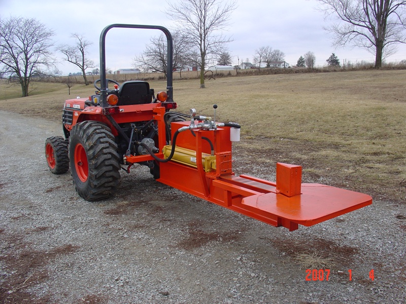

I built a splitter several years ago using the 20gpm pump pictured above. Like SawyerRob I got along fine. Was fast and powerful. I ran it on a B2910 Kubota (30HP) tractor.

I built my splitter and did a thread, but can't find it, seems threads more than 10 years old are purged??? Probably just my ignorance.....
Here's the guidance that I got with the pump as well as a pic of the finished product.

I have a 3 point splitter and in the end it's not that convenient as I split in the same spot. Between tying up the tractor and using a much bigger engine than necessary (70 hp) to run a splitter it's not ideal IMO. It splits great with over 20GPM and over 3,000 psi but If I could do it over I'd probably go with a quality electric unit with a 5 or 7.5 HP motor. Cheaper to operate and much less maintenance.
