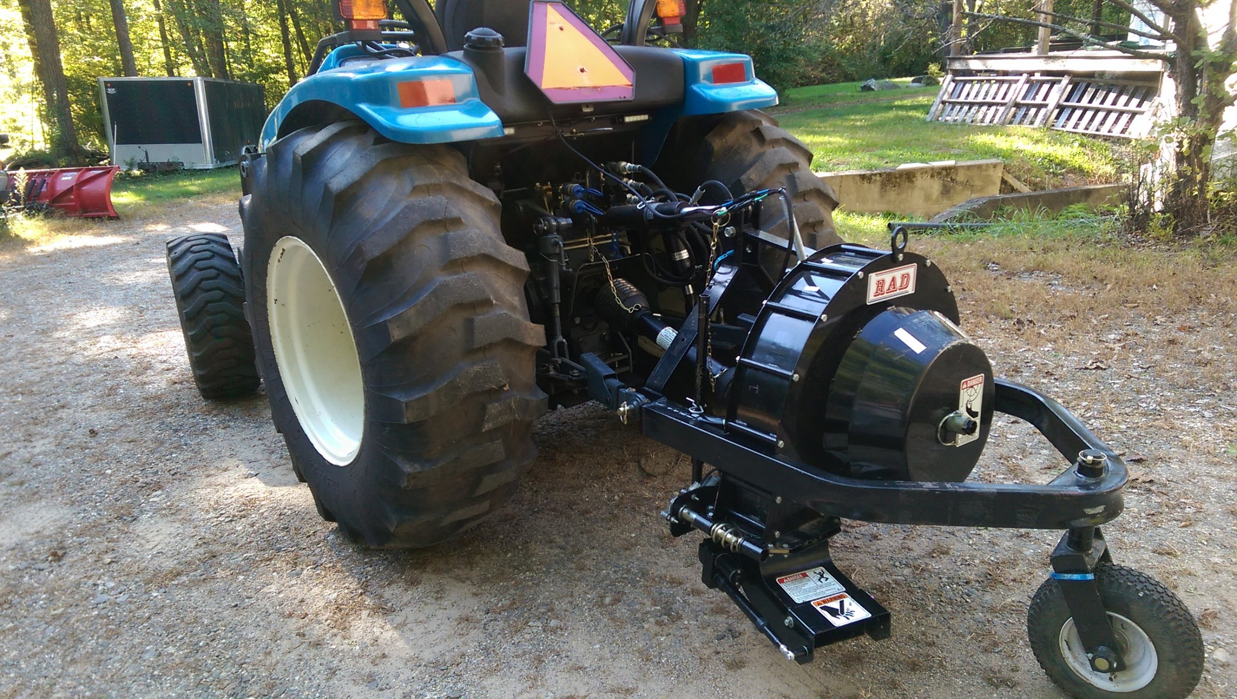

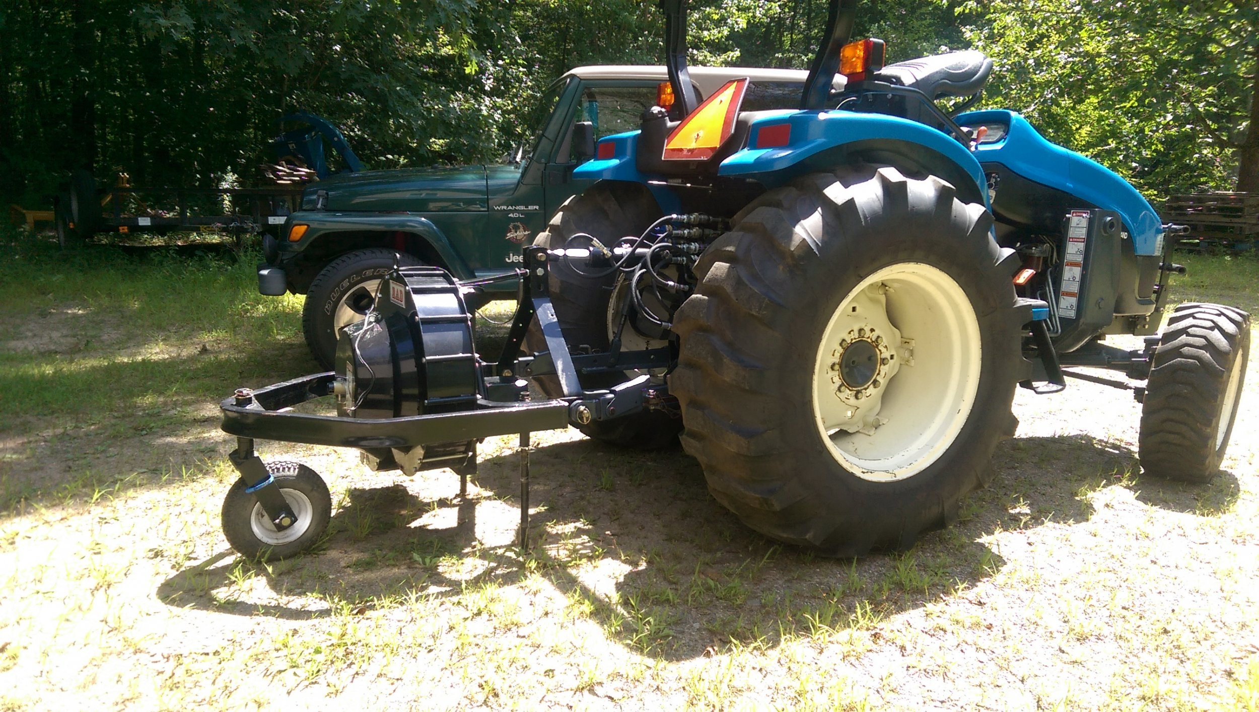

Those look like the Buffalo Turbine blowers.... They are nice blowers. They are used a lot around here by golf courses, towns, & municipalities for large areas. I was luck enough to get to try one prior to us purchasing one (family member works at one of them), they way they are designed they moved to much of the stone where I tried it for me to be comfortable using it in our 1/2+ mile gravel drive. Even lowering the PTO speed below 540 the these things move air.... & our drive & culverts were a major reason for the blower.
We have a PTO Debris Blower, we actually lucked out on a barely ever "used" one that I needed to setup for our use, & I really like it on the back of the tractor... the dust storm is behind me 90% of the time. Now we do not have a cab so that makes a big difference, but even still the amount of dust & leaf debris these things move I would guess you will be cleaning the tractor hood grill of leaves & debris with a front mount more often. Oh, I also use the bucket on the FEL to push the big pile in to the woods or to toss the collected bigger sticks etc. along the drive so just another reason I like the rear mount...
The blower has made days & days of work to hours... you won't be disappointed

The gauge wheel is great... we have a lot of uneven ground.
The Buffalo Turbine I used was a PTO unit & although not having the vertical axis wasn't a real issue for our use I can see it being handy for some situations... Again I still like having the bucket on the front.

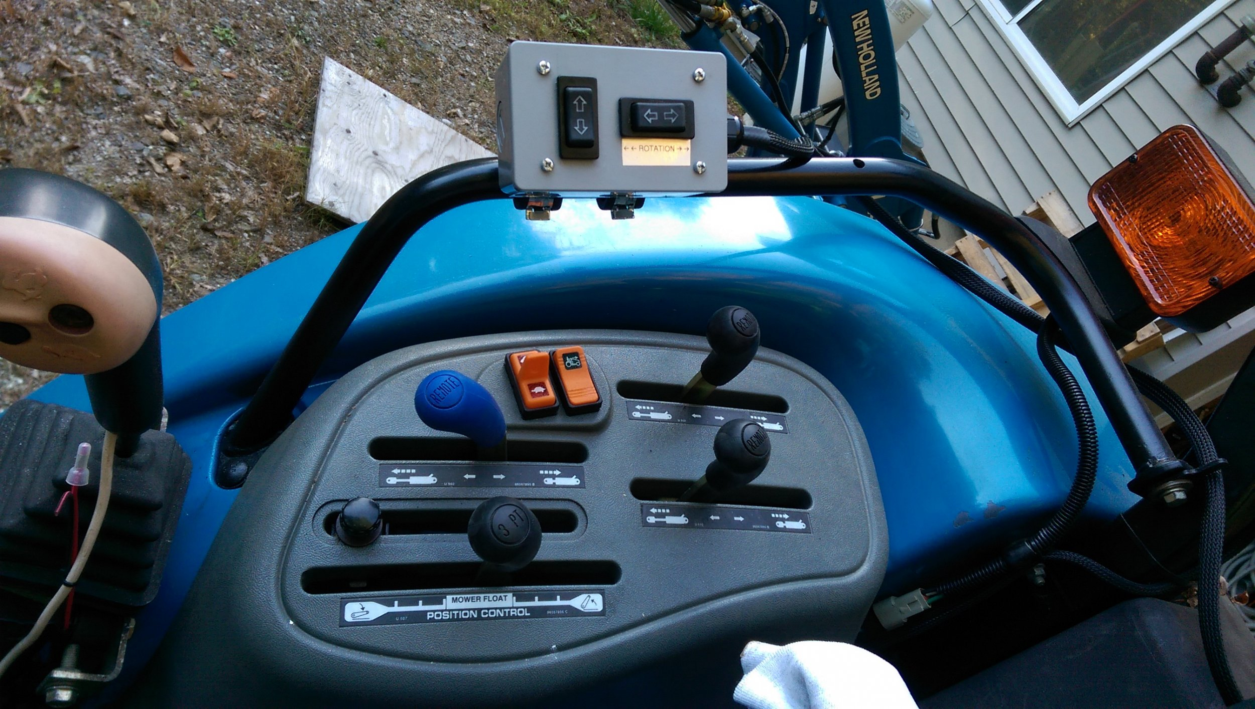

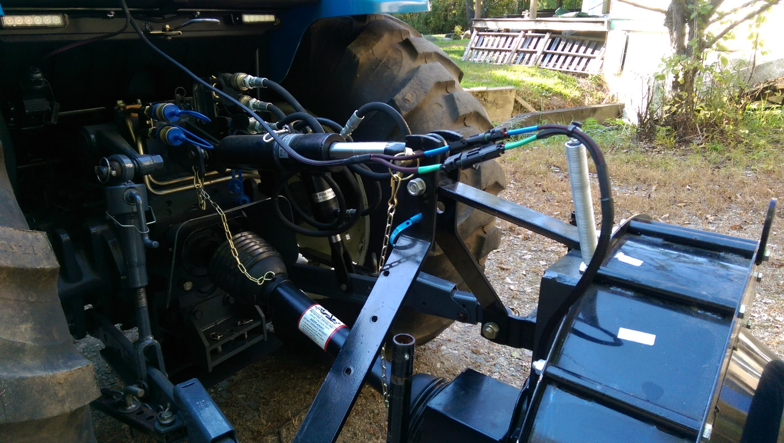

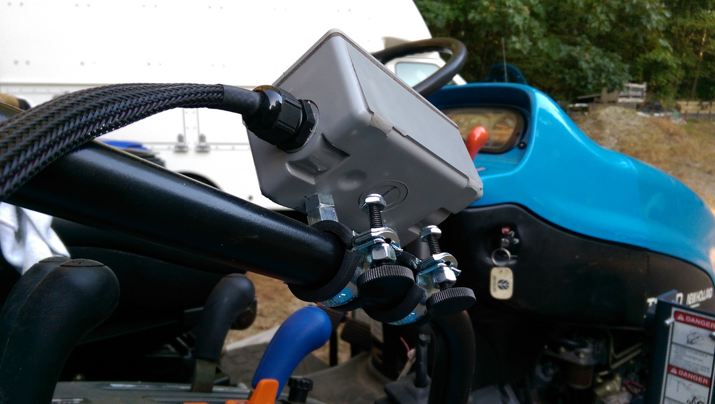

So, our blower has both nozzle rotation (230 degrees left to right swing) & deflector up & down (now - added the deflector up & down). Both incredibly valuable for our needs... rotation = pretty self-explanatory... the up & down of the deflector is a huge help with not moving the gravel out of the driveway & with being able to aim it down into our culverts to blow them out. When we got the unit it was wired incorrectly so I decided to wire it & added the defector motor... so glad I did.
Here are a couple more pics...
RAD Control Box Mounted.jpgRAD Wire Harness Disconnects & Spring Support.jpgRAD Control Box Quick Disconnect.jpg
