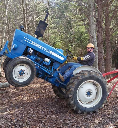

The YM1500 is on the sub-compact frame, s a 3PT PHD has to be a sub-compact to work properly. Full size PHD can often flip small sub-compacts with rocks or other items below the surface soil is hit.
It may be difficult to raise a full size PHD up with a subcompact without he auger digging.
I’ve never heard of a PHD flipping a tractor by hitting something below the surface. Happens often?

Unplanned tractor wheelies are scary as heck!
