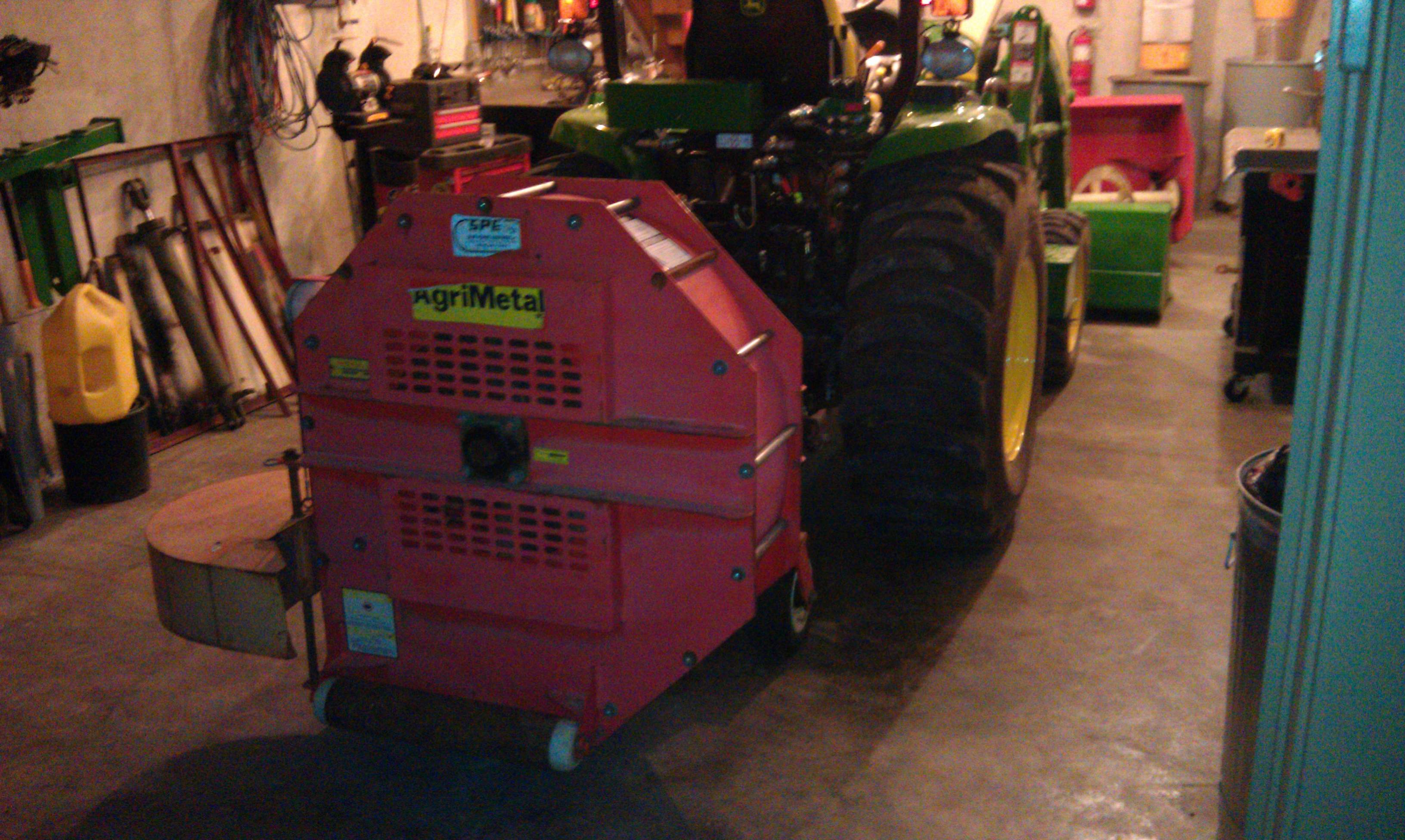

I have a agrimetal........It rocks, but I only get to play with it about 4 times a year. Durning the fall it just stays on the back of my tractor and instead of spending hours at a time cleaning leaves I jump on and get it done in about 5 minutes. It creates so much force that you have to get use to using it or you will blow the gravel off your drive and onto the lawn.
They are expensive and I kinda fell into this one at a good cost......because my buddy use to own a golf course and no longer has a need for it.
