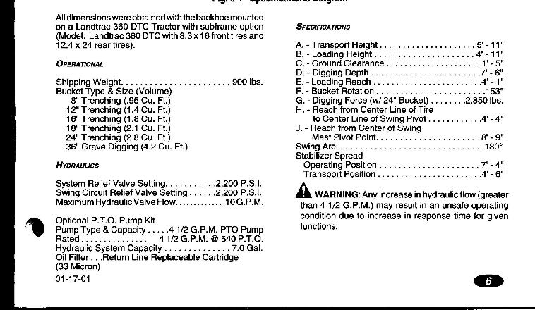

The power is all based on PSI, cyinder size, and the geometry of the hoe. Although there is no hard correlation between 3PH mounts and hoe power, smaller hoes do tend to be lower power, and 3PH hoes tend to be on the small to medium size.
Do you have any specs on your hoe? It's not a brand I'm familiar with. If you have numbers, we could compare with some of the bigger brand 3PH hoes to see if there is a noticable difference.
/ PTO Hydraulic Pump
The backhoe is a Long 4008, the specs are attached.
/ PTO Hydraulic Pump #9
It's digging depth is the same as my Kubota 4690 and the same as a woods 7500. The digging force is also essentially the same.

Ed, you only needed to look on your literature to see that the pump that comes with them is less than 1/2 of what your tractor has. By confirming your tractor is right at the hydraulic outlets you should have more than enough to properly run your backhoe.

My tractor weights about 4000lbs with the loader and BH, and yes, I can drag is around if I try. It sounds to me like everything is working fine. These are comparatively small hoes with limited power. They do great work, but it takes time.
From what you've said I don't think an external pump will change anything. Your tractor puts out enough pressure which is what will give you all the power. A 3PH pump won't give you more. Your tractor also produces more flow that needed, so an 11 GPM PTO pump won't make the hoe faster either.
