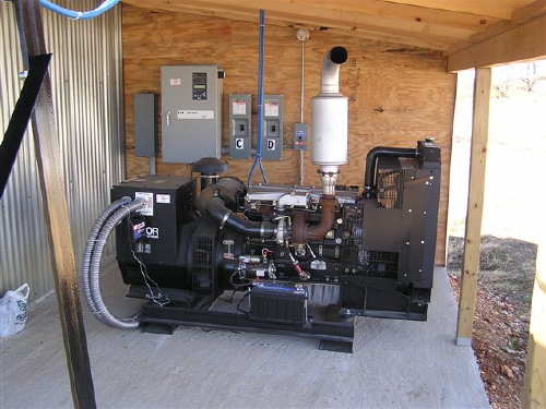

   / PTO Generators any advice? #46
I got a digital camera for Christmas. The pic is a little crooked but I'm still learning /forums/images/graemlins/grin.gif
