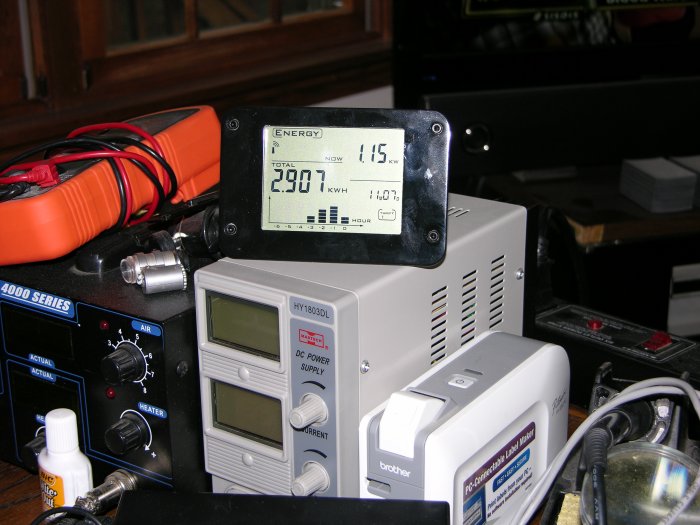

This digital monitor comes with 4 wrap around clamps 2 large and 2 small. I clamped one around each of the incoming load legs from the meter. The probes then plug into the back of a small transmitter that will send the signal a couple of hundred feet to the receiver. It gives a read out in real time and stores a 2 year log I believe. The whole shebang is battery powered.
   / PTO generator #256
Hmm, does it read amps per leg, or just combined amps?
Does it read voltage and/or Hz?
Thanks
Aaron Z
Thanks
Aaron Z
I don't know of any clamp on devices that measure voltage and/or Hz
It measures combined kw usage cost per second, hour, day, week, or month – iConserve conveniently converts energy use to cost per second, hour, day, week, or month. It is easy to adjust iConserve's settings to get the most accurate reading for your time period.
Continuous Recording – iConserve conveniently logs activity.
Graphical Data – iConserve conveniently graphs your electricity use over time.
Alarm Warning – iConserve instantly issues a warning when a high amount of electricity has been consumed.
Backlit Display – Backlit display for quick and bright illumination during night time use.
CO2 Readings – Easily monitor CO2 (carbon dioxide) readings with iConserve.
